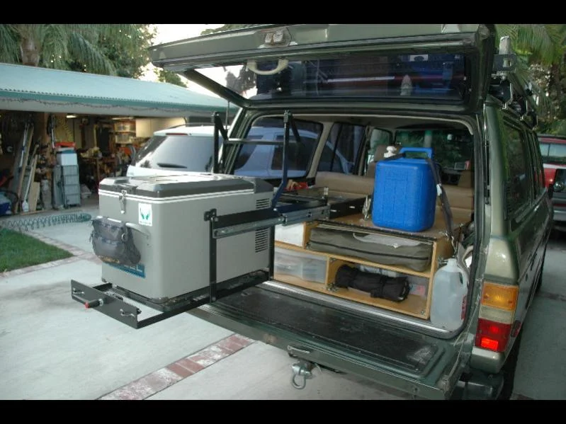

A fridge will only work in the way back if it's on the floor, and the drawer unit is half-width. Can't get at the food with the liftgate above it.
Unless you buy this Australian drop-slide gadget, which IIRC is about as much $$ as the fridge and they don't ship to the US.
http://www.platinumgear.com.au/
Guy on Ih8mud made his own:
http://forum.ih8mud.com/expedition-buil ... slide.html

The Roadie wrote:A fridge will only work in the way back if it's on the floor, and the drawer unit is half-width. Can't get at the food with the liftgate above it.
You read my mind, Bill! I was going to go the way of the guy on IH8MUD and build my own, since if I recall, he couldn't even get the company interested in shipping their units out here. Another interesting idea I had, which would require moving the compressor, would be to have the fridge slide forward and end up in the rear seat area. I'd still have 5 seats while driving, but I'd be able to access the fridge a little easier maybe.
