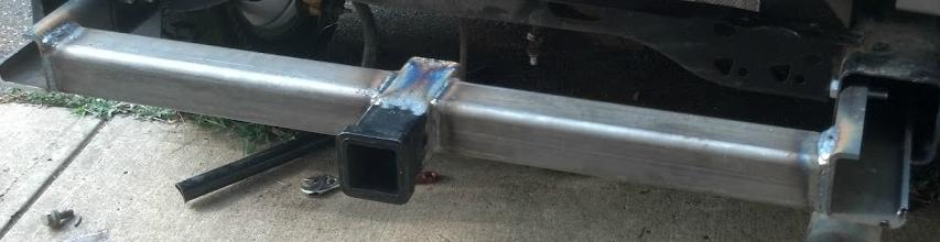

I didn't think it was. I'm not planning on using the impact bar for anything other than keeping the bumper cover formed correctly. I was thinking of building something like this
I realize instead of the tube sliding into the frame I'll have to use plate on top and bottom and attach the receiver through the plate. I was thinking I could have the hitch slide through a 2X2 hole in the impact bar.
As I think about it more I'll likely have to lose the impact bar completely and build something that is a recovery point and support the bumper cover.
by bartonmd » Fri Feb 01, 2013 12:20 pm
Yes, built something the size/shape of the impact bar that you can put a receiver in, and that can support the bumper cover.

I'd build a receiver like you're mentioning and then weld some rod to the receiver frame (like antennae) and weld a flat plate on the end to support the bumper.
I've done this to strip weight off cars and it's simple and effective.

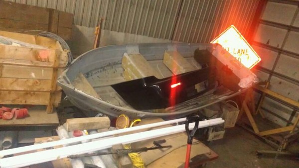

Mike. I do like that option. I wasnt planning to go that route as it would require cutting my SS bumper cover... Then again... Its sitting in a boat in the corner of my shop. Haha
by mikekey » Mon Nov 04, 2013 9:53 am
Wait wait, you're afraid to cut your SS bumper. According to all the guys on tbssowners you've already committed sacrilege. No going back now, lol.
