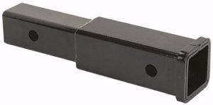

So I'm waiting for the weekend to install my lift and while I am I'm throwing around ideas for my hitch mounted spare carrier.
The hitch mount will accommodate a curt spare tire carrier
http://www.amazon.com/Curt-Manufacturing-31006-Spare-Mount/dp/B0009YIE1O/ref=wl_it_dp_o_pC_S_nC?ie=UTF8&colid=CSWFY029PVHG&coliid=I3OX4YNTA6O13
I've seen the hitch haul but don't really like how far it sticks out and how far it hangs down. I'm looking at a Curt dual 2" receiver that is stacked on top of each other. I like this cause I can still swap out a shackle mount or ball mount in the bottom receiver.
http://www.amazon.com/CURT-Manufacturing-45792-Receiver-Extender/dp/B00371VLAC/ref=wl_it_dp_o_pC_S_nC?ie=UTF8&colid=CSWFY029PVHG&coliid=IZ9RTK91UFCY0
I don't have any previous experience or knowledge of a dual receiver stacked like that so any input or warnings are welcome please.
I plan on cutting down the receiver extension to bring it into the receiver as close to the bumper as possible and will also drill holes and pin it to make it swing down
Also I know many of you are gonna say just get a receiver extension and weld the tire mount to the top of it but 1: I don't have a welder 2: I don't wanna pay the money to have someone else weld it and 3: I would actually rather not have it welded that way if I want to change something I can just unbolt it or pull a pin and play with the design

The only input from me about the top receiver is, built like that, you can't tow or extract with the top receiver. The top one would only be for a bike carrier or tire carrier.
Really, though, by the time you pay $70 for that, and $100 for the tire carrier, you could just buy a tire carrier that has a receiver on it, and swings down. The Curt one you show doesn't swing down. It's stationary.

bartonmd wrote:The only input from me about the top receiver is, built like that, you can't tow or extract with the top receiver. The top one would only be for a bike carrier or tire carrier.
The top receiver would be all time tire carrier mount with the option of swapping whatever recovery or tow equipment in the lower receiver. My plan was to also cut down the curt carrier to bring the spare down to increase visibility out of the back window and while I was at drill a hole in the lower section and the upper and bolt and pin two pieces of plate on either side to make it swing down

So... you're literally buying 2 pieces and modifying one of them for the same price as buying an already-working one that will do the same thing?

bartonmd wrote:So... you're literally buying 2 pieces and modifying one of them for the same price as buying an already-working one that will do the same thing?
Basically it would close to the same thing as the CBI but nowhere near the price tag. Possibly cheaper if Roadie can find the one he has. I'm sure the 2 pieces and some nuts and bolts would be way cheaper than CBI's price
