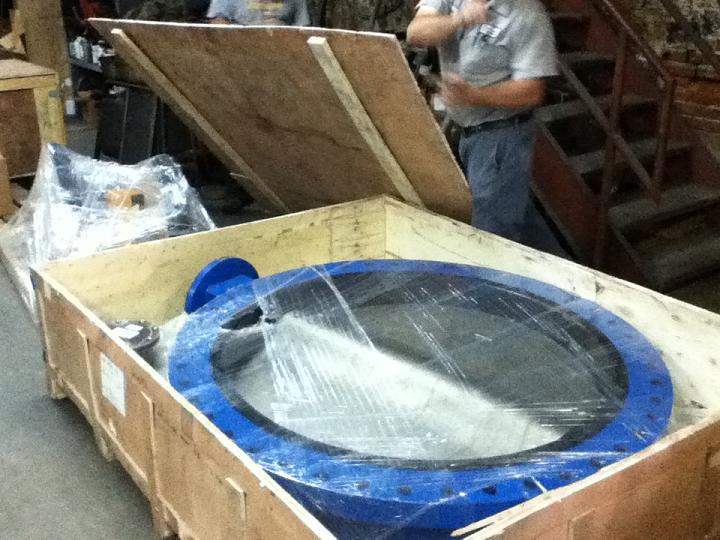

The place I work for specializes in valve actuation and piping for industrial purposes, that's why I was curious about your materials. We carry all the stuff I mentioned. If this works out for you, it might be an avenue I may just have to take a stroll down.

by Moots1288 » Sat Jan 26, 2013 11:46 pm
Conner299 wrote:The place I work for specializes in valve actuation and piping for industrial purposes, that's why I was curious about your materials. We carry all the stuff I mentioned. If this works out for you, it might be an avenue I may just have to take a stroll down.
That looks like a butterfly valve for a big gas main.
by Conner299 » Sun Jan 27, 2013 12:12 am
48 inch butterfly. Forget who it was sold to or the application. I do have a five minute video of the opening of it, after we had automated it.

by Moots1288 » Sun Jan 27, 2013 12:16 am
We use those for gas mains here so I'm assuming that's what it's for lol
