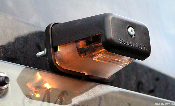

The light has a small bracket that attaches to the aluminum extrusion. It lights up!

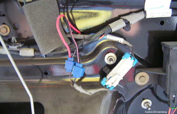

I had to take apart the inside of the gate in order to find the leads. Brown is power, black is ground. Seems to work well.

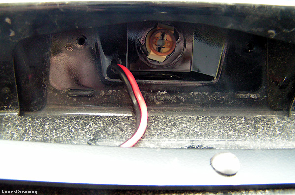

The wires are fed through a hole I drilled next to the old LP lights. This hole is covered by the LP light covers. It should prevent most moisture/dust from entering the hole.
