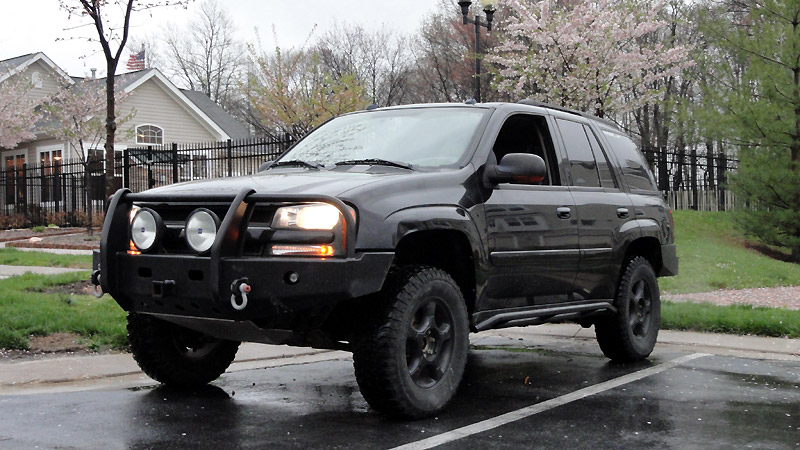

2. All I want to do to my truck is.. everything, meaning I really just want to get atleast 3" lift on the entire truck, some nice AT tires as well, but also level it out. I'll get skid plates, a front steel bumper, get the spare tire on the back, maybe on top. I want it to look something like the picture below. I read something about the front diff going through the oil pan or driveshaft somethin, and that allows only so much lift but I was wondering what I can actually do if I have everything stock right now.

That picture was with BDS 2" + 87 springs in front and Z71 springs in the rear with 32" tires. Those three things will get you there, but you need to upgrade wheels or get wheel spacers, plus you'll want to upgrade shocks while you're in there. 1200 might be doable, but you'll need to skimp on the tires. Tires alone can be 1200 easily.
