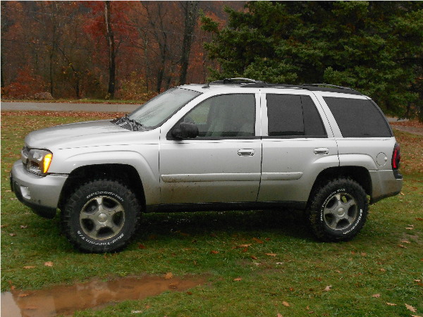

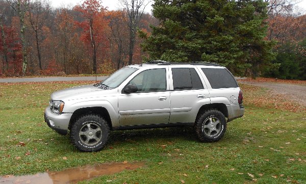

Thought I'd drop in and say hello. Just lifted my '05 TB :flex dirty: . 3" Ebay lift, BDS rears, Bilstein HD's, BFG 255/85R17's.
Looks good, feels good... just need G80 now.

by ksmarshall » Sun Oct 28, 2012 10:28 pm
welcome , pictures???

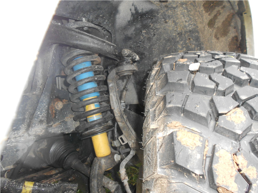

Ebay vendors are STILL selling the Readylift style 2-3" OUTSIDE the strut spacers. Criminally negligent to sell those to a 4WD vehicle owner because of CV damage risk, and very, very risky to install even on a 2WD due to ball joint damage.
For only $75-130, these kits get a lot of frugal owners suckered in if they don't do the research first.
Welcome to ORTB, but please let us know more about the lift you bought. We're worried for your safety if it was one of the cheapies.

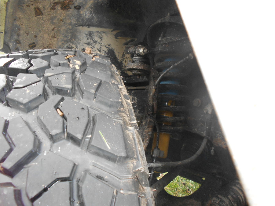

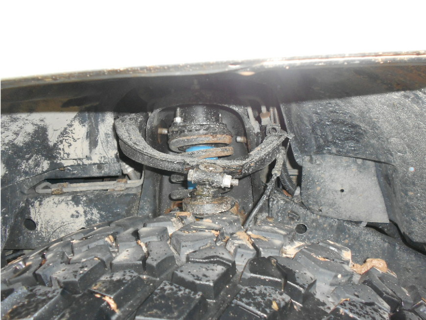

A lil hole called Bergholz, SE tristate area... tons of off roading to do hear. I was scepticle about the lift also, but for the price I had to see for myself. The balljoint angle WAS maxxed, I flipped the UCA's and all is golden now. I've spent almost 2 weeks putting the test to it... even catchin AIR a couple of times, and there is no probs at all, no alxe rap at full ext, the only thing was the strut arm hit the coil springs before i moved the LCA's out, but now they clear by almost 1/2" now. I don't want to offend anyone with my first post, but I truly believe this kit is solid. I will keep updated.

by navigator » Mon Oct 29, 2012 10:38 am
suzukiz wrote:
HARDTRAILZ wrote:Welcome, what part of OH? And Roadie is correct...your lift may do harm to the vehicle and leave you and others on the road in danger if it is outside of the strut.
..... no alxe rap at full ext, the only thing was the strut arm hit the coil springs before i moved the LCA's out, but now they clear by almost 1/2" now. I don't want to offend anyone with my first post, but I truly believe this kit is solid. I will keep updated.
I don't think anyone would be offended. Our goal here is for folks to get out and explore more and be safe while doing so. Those outside the strut (OTS) lifts just concern us because it is more likely for them to cause the CV to bind at full extension and the extreme BJ angle is a major safety concern.
You might be the first to do a UCA flip with an OTS lift so some up close pics would be great.
Have you jacked up each side up front and checked your rotation at full droop to confirm there is no binding?

Yes, I had jacked the front and check at full turn also, my driver side inner CV boot was blowin grease, added 4" hose clamp and all squared away.
Here are a couple of pics... I only took some of the driver's side cause it is rainin like crazy (wooha maybe some floodin to go play in)
