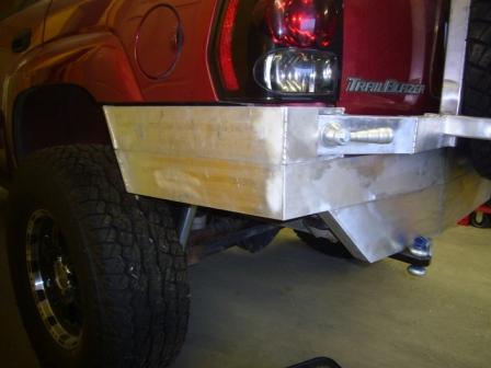

Erik,
ErikSS wrote:Did you get plate aluminium and just start cutting and welding?
The bumper is not plate, it is stacked channels, 6" x 2" on bottom centre with two 4" x 2" above. The channels are bolted together top to bottom with the ends and corners welded.
Ron

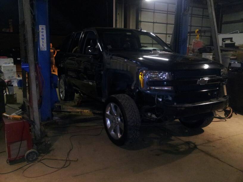

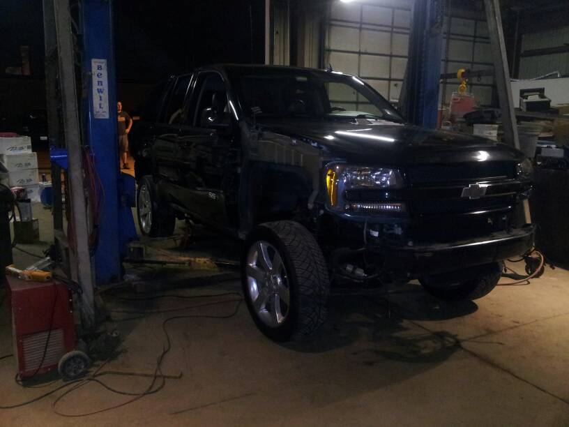

by ErikSS » Sun May 19, 2013 1:56 am
The build has begun! A big thanks to AJ (hotness) and my buddy Rob for helping out Friday night and Saterday. I lifted the body but need bolts and brackets to finish (stupid post office). I went with AJ's old stock springs, OEM SS struts, and MarkMC's new 3" front. AJ and I designed a fairly quick and easy way to change the air bag sensor. We are going to try rear spring spacers under the air bags (stupid post office). It's 1am, but it was a good day. I will try to post a teaser pic or two tomorrow.
by bartonmd » Sun May 19, 2013 11:44 am
Ok, so you don't need to borrow my stock lifted struts, right?
by ErikSS » Sun May 19, 2013 3:35 pm
bartonmd wrote:Ok, so you don't need to borrow my stock lifted struts, right?
It looks like Im going to be ok. I was waiting til I could put it on the ground and check it out before I said something. So far so good. If the post office hadnt lost one of my packages I would be 100% sure. I have this pic so far.

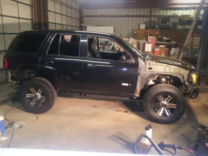

by ErikSS » Mon May 20, 2013 10:56 pm
This is how I left her tonight. Im still adjusting the radiator brackets. Ive cut the ears off the bumper brackets but nothing else yet.

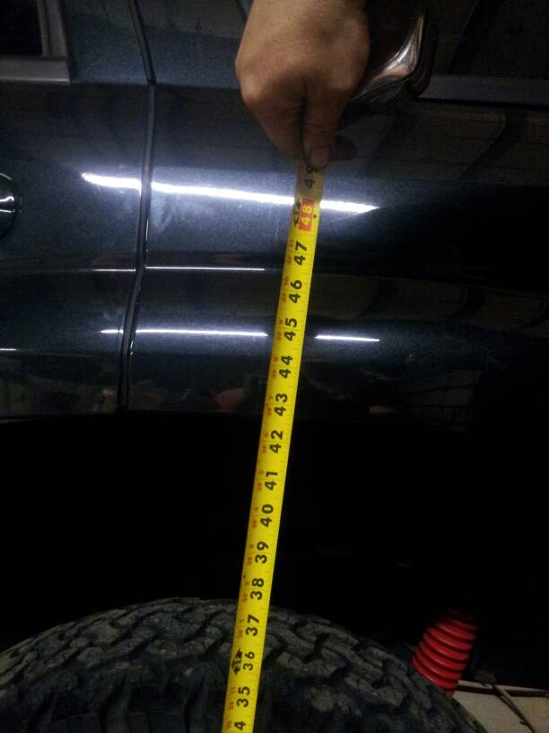

by ErikSS » Mon May 20, 2013 11:13 pm
This is a rear fender well. If Im not mistaken... Im still at least 1.5" shorter than Hardtrailz... dang
by Regulator1175 » Tue May 21, 2013 12:03 am
ErikSS wrote:This is a rear fender well. If Im not mistaken... Im still at least 1.5" shorter than Hardtrailz... dang
and a few others... :raspberry:
Seriously though, it is looking really bad ass! I can't wait to have a chance to wheel with an SS!

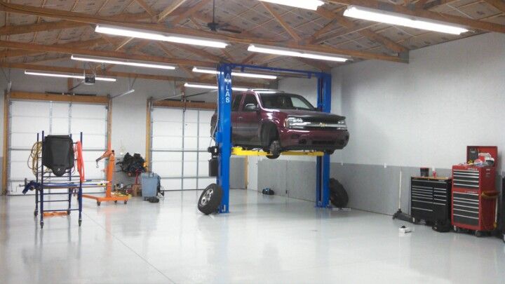

mikekey wrote:Nice perk! I'm thinking of adding a two post lift to my garage. The prices on them are just right
Anytime I playfully want to make the wifey mad, I tell her this is the only reason why I married her...
The Father-in-Law's garage...
You're 1 inch shorter than me for the time being.
