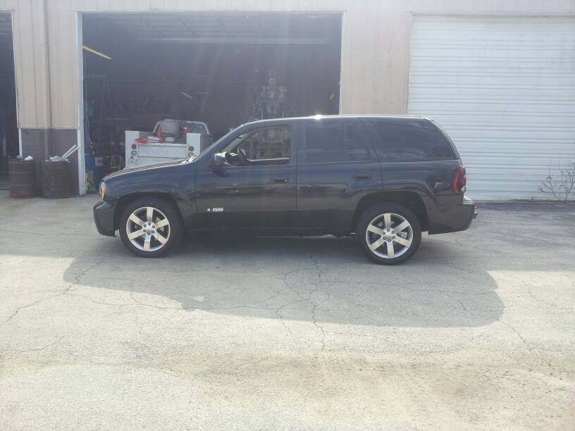

by ErikSS » Fri May 03, 2013 11:02 pm

by mikekey » Sat May 04, 2013 3:36 pm
:need pics:

by mikekey » Fri May 10, 2013 10:51 pm
again, you have yet to :no pics:
:finger: :poke: :finger:
