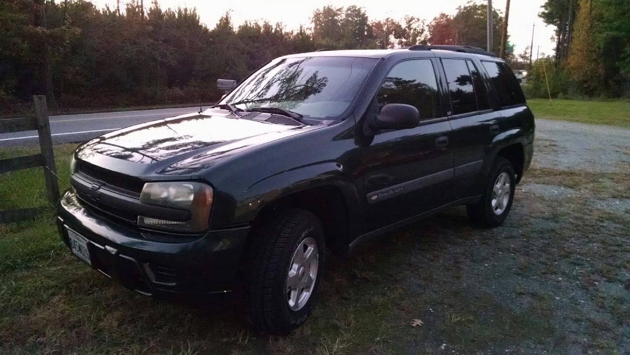

I've looked around for a couple of days and gleaned a lot of good information here. I've recently acquired a 2003 Trail Blazer and want to tweak the suspension for towing and launching my boat on mossy launch ramps. When I took possession of my LS, it was severely cutting the right front tire. The alignment shop said it would require uppers, lowers, and one tie rod end. At 166k I figured I'd better get under there a check things out for myself. So far I've replaced uppers, lowers, both tie rod ends, stabilizer links, shocks, brake pads, and one CV boot. While I had the shocks out, I added a Traxda 2.5" leveling kit and am leaning toward Monroe coil overs for the rear. As it will be my daily driver, I don't want to go all out rock crawler, but do want some added clearance. I've pretty much settled on BFG 235/85/16 KO2s on stock alloys. I'm hoping by going with this narrower tire, it will eliminate the need for shaving the upper control arm, and give me another inch+ of clearance. I don't plan on a whole lot of situations where I'd need the added flotation of wider tires, and want to maintain decent gas mileage. I'm also a little gun shy about wheel adapters since my '67 bug lost a rear tire on the hair pin road from Skyline Drive into Sperryville, VA. :shock:
