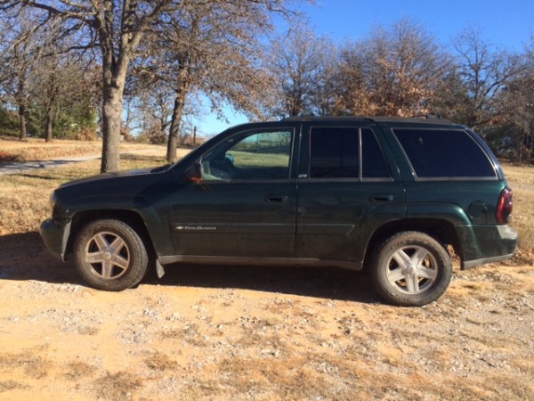

It started life like looking like this:

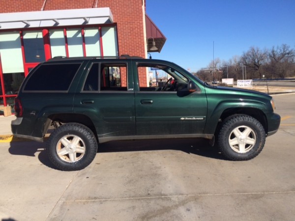

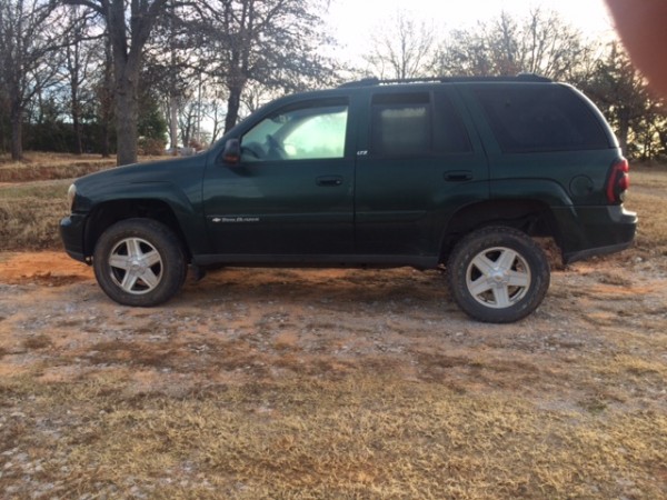

After a Lift Meister 3in lift and 1.5in wheel spacers, it looks like this. In addition to the lift and spacers, I put on z51 rear springs which really pushed the rear up into the air. It's a lot of spring for the unloaded weight but should be nice with a rear full of gear. In the rear between the springs and the spacers, the stock length shocks are pretty much at full extension so some longer shocks will be coming soon. I'm also going to build a new set of control arms and panhard rods to true everything back up.

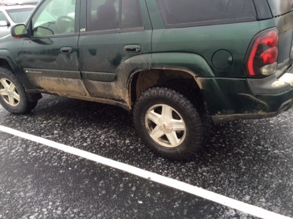

Finally, I got some new shoes on it. For this round, I went with the Goodyear 255/75/17 Duratrac tires. This based on way too much reading and over-analyzing every facet of information from tire weight to number of plys to siping and the like. In this tire, I felt like traded some toughness especially on the sidewalls for a lighter wheel and better onroad traction for inclimate weather. The only real test I've had has been in the form of a recent ice storm and they performed exceptionally. The little off-roading I've done, they have performed well around the property.

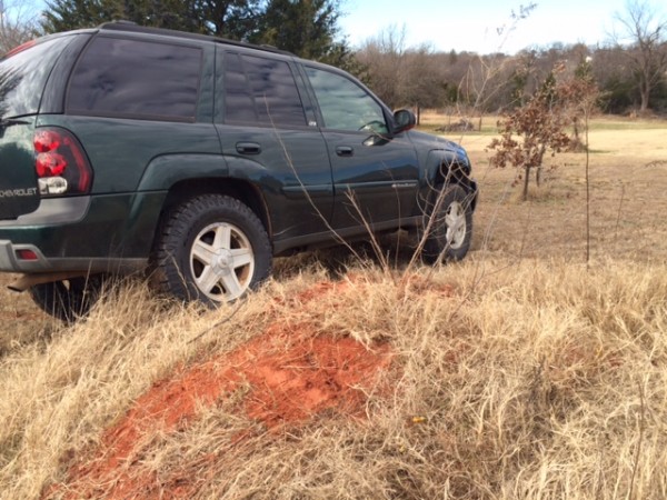

Finally a little testing on a 3ish foot mound of dirt.
And a little more (pulling out guys in 4x4 trucks and mud tires with undersides cleaner than the cabs).
