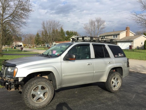

Today
Suspension/Drivetrain Modifications

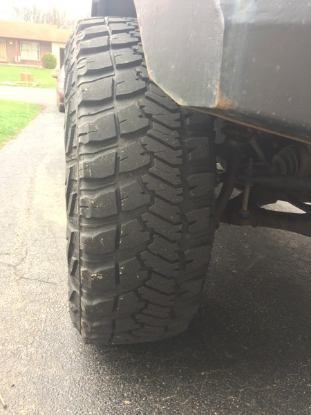

Falken Wildpeak A/T3W LT285/75R16
Mark's 6x5 to 6x5.5 wheel Adapters
Front

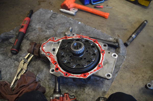

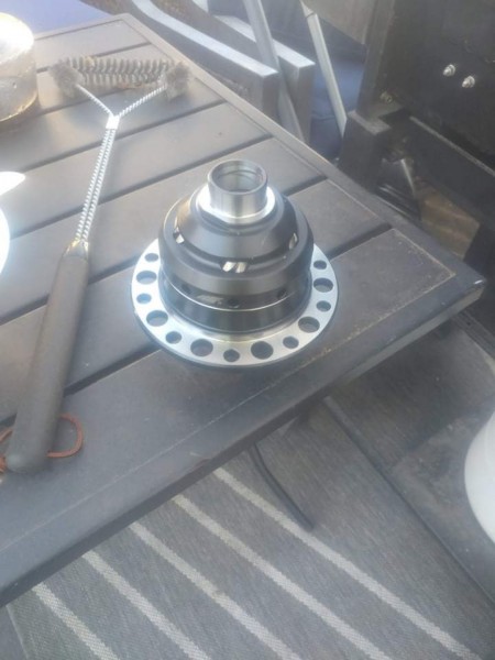

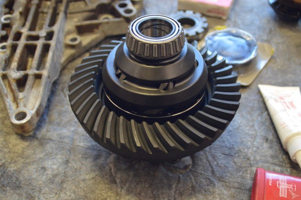

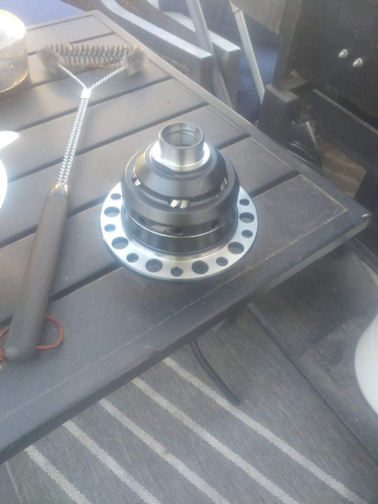

Front Diff 4.10 gears with LSD (helical-shaped gears) from Bully Racing
Cheap AWD Sleeve conversion
Bilstein adjustable struts at max setting with 1/2" spacer on top with Moog 81114 springs.

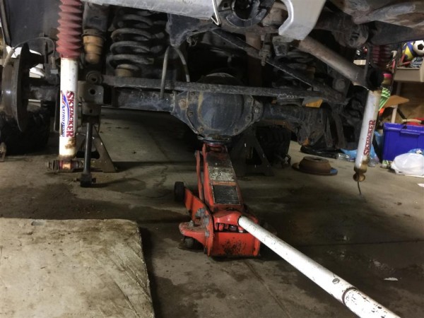

Rear

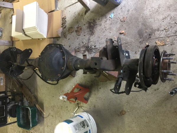

SS Axle 4.10 gears, G80 Installed 2/2022
Skyjacker Softride Coil Spring C25R
Bilstein 5100 Offroad Shock24-185783 F4-BE5-6682-H8
Rear Sway bar deleted
Exterior Modifications

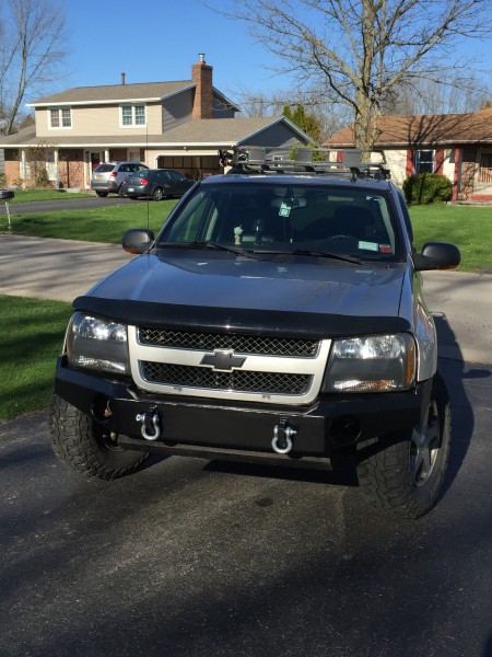

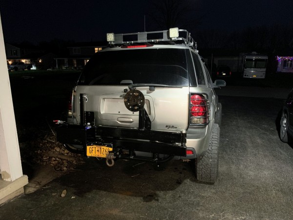

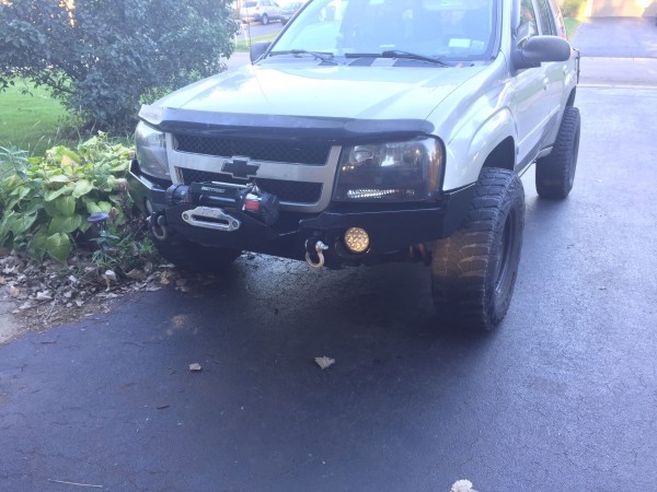

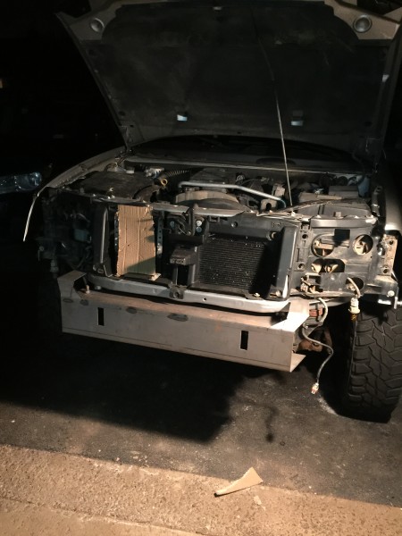

MDB LT non-BL winch bumper
Oil pan skid plate Here
Custom made RAD Skid Plate made by V7Guy

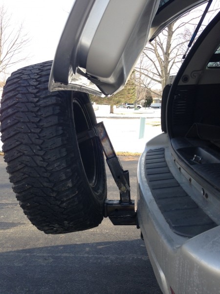

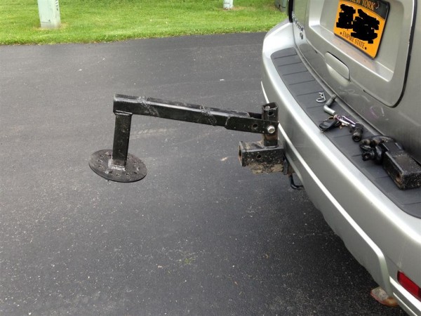

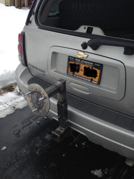

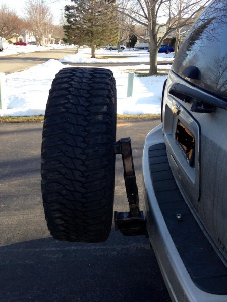

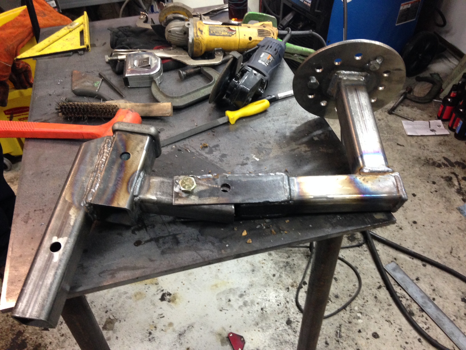

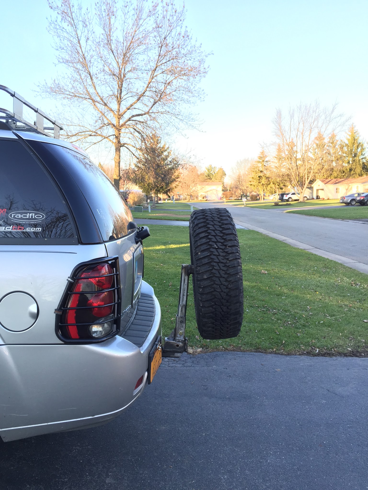

MDB Hitch mounted swing out tire Carrier

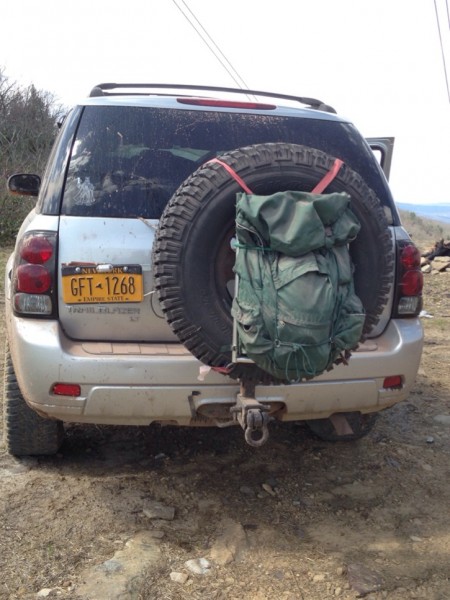

Improvised "Trasharoo" on the Spare Tire from a old frame back pack

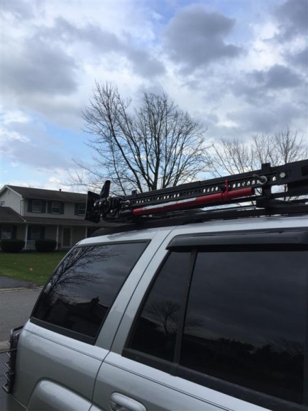

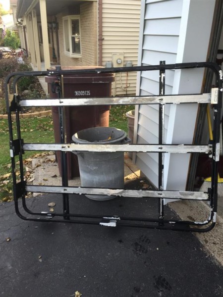

Surco S5060 50 x 60 Safari Rack
Wife proof rock sliders

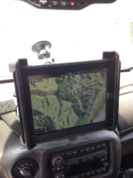

iPad Mounted with a RAM mount with the following applications
1. Off network Topo Maps
2. Dash cam
3. Scan tool using ELM327 WIFI & OBD Fusion on iPhone Dash Commander

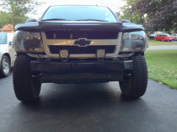

2 - 4" square LED work lights (1550 lumens) mounted on rear roof basket, hooked to a 3 way switch. reverse - off - work
43" LED light bar (20K lumens) mounted on front roof basket

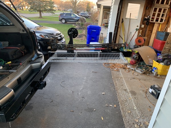

Hi-Lift Jack HL484 48" Hi-Lift Black Cast and Steel Jack
Hi-Lift Lift-Mate (LM-100)
