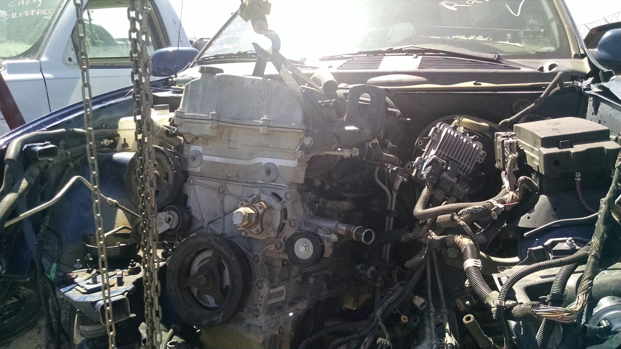

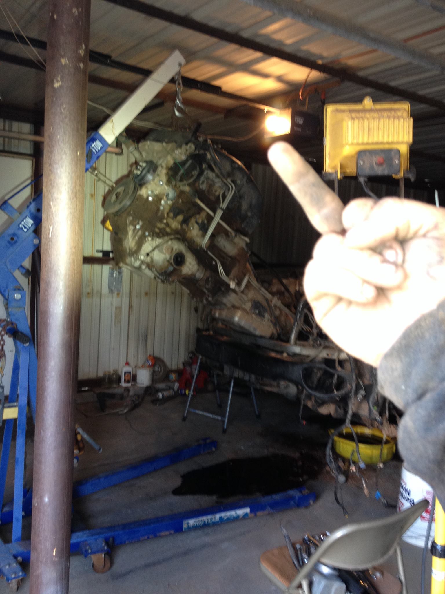

So began one of the longest months of my life working until dark after work on this d@#$ed truck!
Yeah, that pretty much sums up jerking engine and tranny from a GMT360.

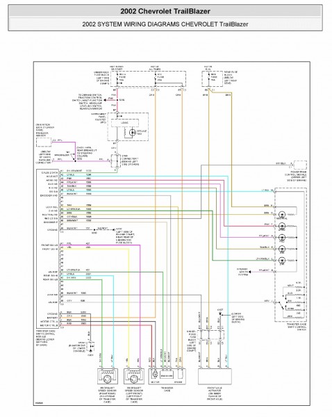

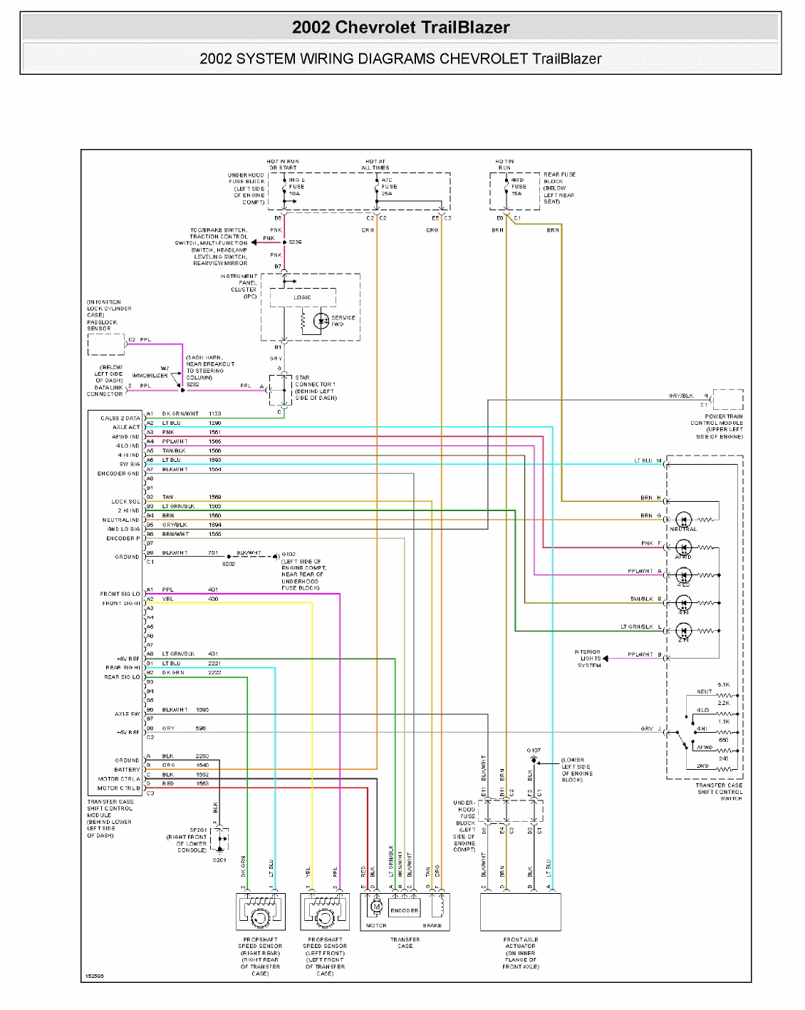

Using this wiring diagram that I found on the net from a once-great forum, I began tying wires in where they go.
OK, now to some, this may look difficult, but it's actually quite awesome because, electrically, this is our 4wd system.
If one wishes to partake in this endeavor, remember to get BOTH "data" pigtails from the donor TB TCCM harness, and for time's sake, it's easier to just remove the entire wiring harness that runs from the ECM down along the driver's side frame rail, all the way back to the trailer plug. Once you get home, you can cut out what you need. You WILL need to run a few wires into the cab through the firewall grommet. I found that a cleaning rod to an AK works wonders here for fishing through it.
Use heat shrink on all your splices and wrap generously with loom tape or electrical tape, then replace the plastic loom.
I also gave myself an extra six inches for the encoder motor plug.
