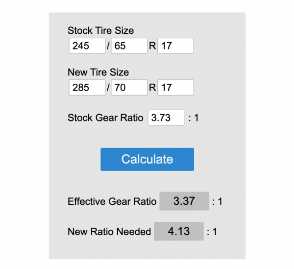

I was able to use my HP tuners to get the speedo and trans shiffting right when i upgraded to 32" tires on my 2008
I downloaded a 2003 file for hp tuners to see what it said and ys... its just some wierd ratios in the speedo section for you.
You may be in luck though because according to tiresize.com a 285/70r17 which is about 32.5" and 4.10 gears make the output shaft spin at the identical speed as the stock size tires with 3.73 gears.
just run them
