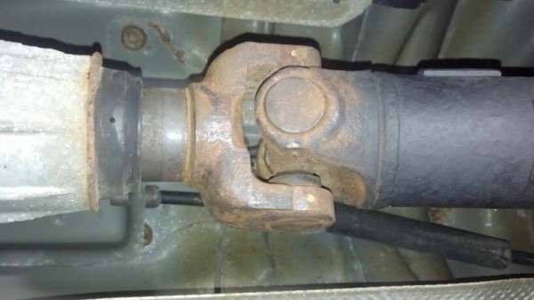

by Chango » Fri Aug 01, 2014 2:48 pm
Got mine back today. Took 1.5" off and fit like a glove. [attachment=-1]uploadfromtaptalk1406918889869.jpg[/attachment]
