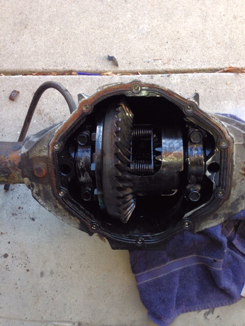

Forgive my ignorance here, but I got an axle assembly off the 2007 4.2l tv/envoy Saab equivalent. It was super cheap and the guy said it had a g80 locker. 100 dollars and a little clean up I could resist.
Get it home open it up and it looks nothing like what I thought a g80 would look like and I have no idea what the positrac or standard diff looks like. Don't have much experience with the rear.
You guys know what this is?

by navigator » Mon Jan 20, 2014 4:39 pm
it's not a great picture but it looks a lot like my G86 which is a limited slip.
by JustliketheRazor » Mon Jan 20, 2014 4:43 pm
Ah okay. Thought it looked that way too but wasn't sure. And I had to resize my iphone pic so it turned out hazy

by navigator » Mon Jan 20, 2014 4:44 pm
it is just really small and hard to see the internals of the carrier.
by JustliketheRazor » Mon Jan 20, 2014 4:51 pm
Maybe this resize will work

by navigator » Mon Jan 20, 2014 5:27 pm
yeah, pretty sure that is the G86 limited slip.
The same thing happened to me, I wanted an open 8.6 and they sent a G86.
I had already purchased a no-slip locker to go in mine so I sold it to a fellow member.
I'm going to install mine and run it until I find a reason to upgrade.
by JustliketheRazor » Mon Jan 20, 2014 6:04 pm
Well lol for a 100 dollars I guess a g86 isn't bad. Do you like the g86? Also how to you align the spider hears to get that bolt in? I pulled it all the way out and then spun it accidentally. Whoops....

Yeah that's not an open Diff. Here's a picture of an open diff. Forgot how to resize :facepalm:

You mean you took the diff cross pin out and spun the diff? Good luck. No real trick to it that I know of, just have to get it back in the exact sweet spot again.
by mikekey » Mon Jan 20, 2014 11:57 pm
They look "open" to me....
lol

by JustliketheRazor » Tue Jan 21, 2014 12:56 am
Well been doing research, and apparently from the looks of it, both the Saab 9x-7 4.2l and 5.3l came with the 8.6". The 4.2kl got the G80 limited slip differential, different than the mechanical locking version and the 5.3l got the G86 like the SS

by JustliketheRazor » Tue Jan 21, 2014 12:54 pm
Alright guys. Confirmed. That axle off the Saab is indeed an 8.6" GT4 G86. The same limited slip on the SS.
Had guy send rpo code pic, vin pic. Crossed referenced those, and looked up set of numbers on gear ring.
Pretty awesome for a 100 dollar axle and the dude said he'll "guarantee" parts for 6 months
