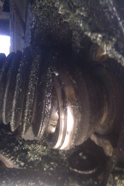

So I have a question related to this. I keep ripping my outer CV boots both driver and passenger side have now ripped twice. Has anyone had this issue besides me? If so are they replacing them with a similar silicone one used on the tripod side?

by v7guy » Mon Jan 09, 2012 12:59 pm
This is the first time I've heard of the outers ripping. Do you have any pics?
For reference I've got several hundred miles on the silicone boot and it's been holding up.
by fishsticks » Mon Jan 09, 2012 3:00 pm
The outers have lots of ribs on them.... only time I've ever ripped an outer is when I blew up the joint.

by Jackstand » Mon Jan 09, 2012 3:36 pm
I dont think mine are blown up? If they were why would two of them blow up within 5000 miles... Driverside is brand new and all of this happened within 5000 miles of lifting it. Sorry for the crappy cell phone picture

by Trail X » Mon Jan 09, 2012 3:41 pm
I doubt yours are blown Nick. It should be very noticeable when the joint is broken.

by v7guy » Mon Jan 09, 2012 5:33 pm
Have you been taking it anywhere where something might rip the boot? As far as normal wear, that seme pretty abnormal to me, I'm not even sure what would cause it, they're not at some crazy angle. Did the last ones rip in the same place?
by Jackstand » Mon Jan 09, 2012 5:48 pm
Yup the ripped almost in the same spot... The only off roading I've done since the lift is the trails to my hunting shack but nothing crazy
