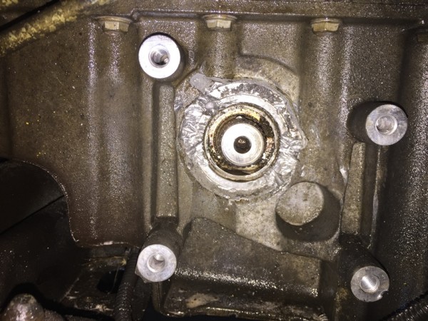

Your grease looks pretty good. What was the reason for your rebuild? Normally extreme wear ends up turning the grease totally black.
You suggest using a screw driver to pop the tripod housing back into the assembly. Where do you put your screwdriver head? I don't recall any location on the tripod housing that would allow this.
On your last image, the 4 nubs in the aluminum housing are ground down. That might pose a problem for the assembly in the future. One potential fix is to drill a blind hole, run a screw into the hole, and grind off the head in order to simulate a new nub. Grinding might be difficult though, without a dremmel.
