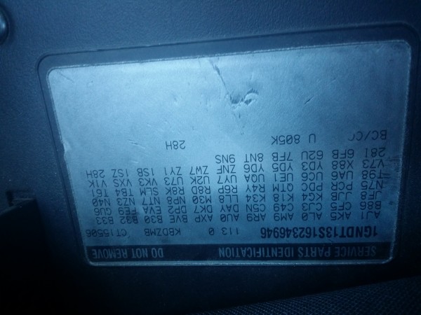

by jamesrivers4 » Mon Jun 08, 2015 11:57 pm
here's a picture of my information panel... I have 17 inch wheels. Pretty sure it's a 8.0

by Anthony Hernandez » Tue Jun 09, 2015 12:20 pm
Yea man just open the glove box, click the tabs to make the door come all the way out and look at the little sticker with the vin number and rpo codes listed. Those are the options that specific vehicle was set up with. Of the little alphanumeric 3 digit codes you want g80 or g86. That'll give you your gov bomb locker you want so badly.
