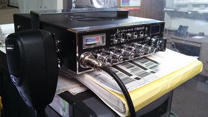

Recently, I was able to acquire a CB very a reasonable price. $50 for a Cobra 29 LTD BT. Its a very gently used unit I got from the brother in law. Its a little bigger than what I wanted to go with, so a dash mount is going to be in my future. Instead of drilling holes, or zipping screws, Ive decided to give 3M command strips a shot. I figure four, trimmed down to the width of the mounting bracket should be enough. And of course, keep the tabs exposed if removal is required at a later date. A peak and tune is also in this unit's future as well.

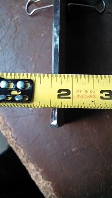

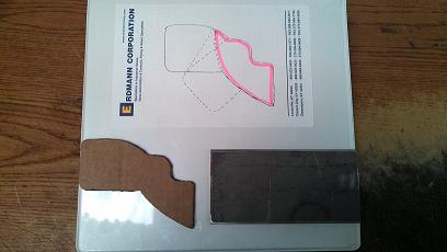

I really like the above the taillight antenna mount, and that is the route I have chosen to go. I decided to see what i could do about building a better mouse trap though. *disclaimer: I do not mean to offend anyone's feelings or fab skills* Most of the above the taillight mounts seem a bit lacking. Both in function(solidity) and astetics. I wanted something that looks a little more robust and a bit more factory. I got out the cardboard and utility knife and started making templates. For the material, I decided to go with some 304 SS we had lying around the shop. I'm currently waiting on our plasma cutter to get fixed, so it can be cut.

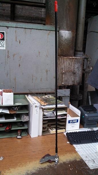

Antenna is a Firestik II 3' tunable tip.
2 questions: Should I run string to get a more precise length, and have the antenna cable made locally? Or, should I just order an 18' length and wire it, coiling in figure 8's where there is excess?

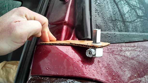

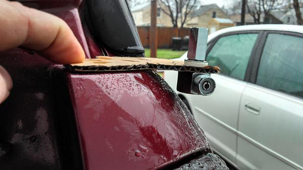

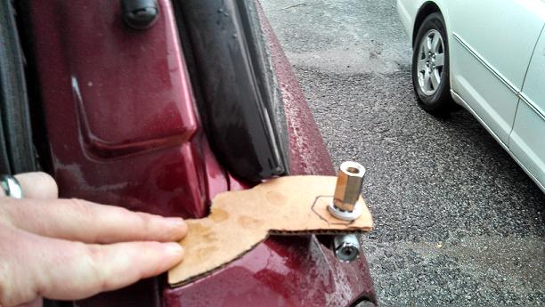

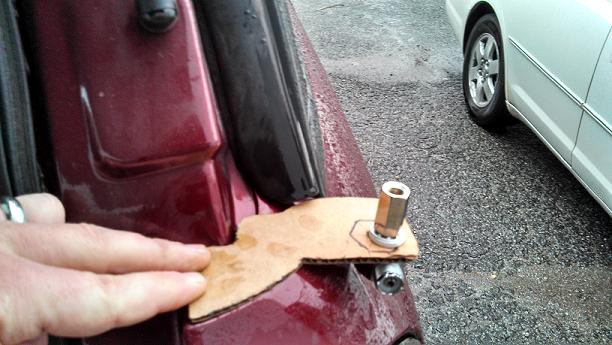

Well, I finally went out and bought the antenna mount, and a power cord for this install. Both pieces were bought at Copper's Electronics here in Louisville. My antenna finally showed up in the form of one of my Christmas presents. My brother and father-in-law thought it would be funny to wrap it up. Below are pics showing the cardboard mock-up with the antenna mount. The mount is bending down a bit due to the weight of the antenna mount.

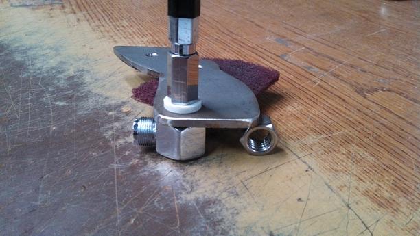

by Conner299 » Fri Dec 28, 2012 5:06 pm

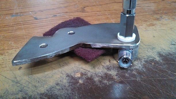

Well... Finally got the the taillight mount plate cut out. Did a little bit of rough work on the shaping. Going to take it home, over the weekend, and do some fine work with the Dremel. Thinking about either painting it black, or trying to do a machined finish of some sort on the top and bottom faces. Leaning towards paint, right now. Didnt really want to have the antenna mount that close to the back corner, but kinda had to with the body lines. It was either that, or have a nice rib catcher, about another inch out from the vehicle. Enjoy...

by SaltWaterDrinker » Sat Dec 29, 2012 1:08 am
Nice. Be sure to ground it. Good look on it though.
SaltWaterDrinker
Posts: 465
Location: PA, Philadelphia
by Conner299 » Sat Dec 29, 2012 10:26 am
SaltWaterDrinker wrote:Nice. Be sure to ground it. Good look on it though.
Thank You, sir. Its always nice to hear when someone likes your work. As for the actual install, I have a buddy who is a storm chaser here in KY, and is also a licensed HAM operator, and he is going to help with the overall fine tuning of the system. I also did some research on the "peak and tune" of my CB. Turns out, it can be done. And I have decided to do it myself. I have already ordered the parts from Radio Shack, and the overall work looks rather simple. Ill include a link for anyone else with a Cobra 29 LTD, with or without BT.

I probably would have used a different antenna mount to better protect the coax, but I definitely like the mounting plate. As Josh said make sure you have a good bond to the body to provide a good ground plane.
