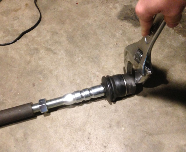

My 15 inch adjustable fits fine.
by Trail X » Wed Jan 29, 2014 11:23 am
Wait, Mike, did you use a crescent adjustable wrench, or a pipe wrench?
Moots, I meant a pipe wrench on the inner tie rod ball housing. For clearance, I think the key is to turn the steering wheel so the rack is sticking out a bit from the subframe. At that point, shouldn't be too hard to get a 15 in wrench on it. Seems like a crescent wrench would be even more difficult to fit in there since the flats are on the back side of the joint, and there are only two flats. A pipe wrench can bite in at any angle and doesn't need 180 degrees to turn before re-biting in.
by mikekey » Wed Jan 29, 2014 11:31 am
Crescent. Maybe I'll get a pipe. My Crescent doesn't fit my Fabtechs. :facepalm:

Looks like you can generally get a 12" pipe wrench to work on a 2" diameter. Mike, I'd try that. The biggest question though is if the teeth of the pipe are hard enough to bite into the ball joint housing. I'd bet it will, but who knows.
