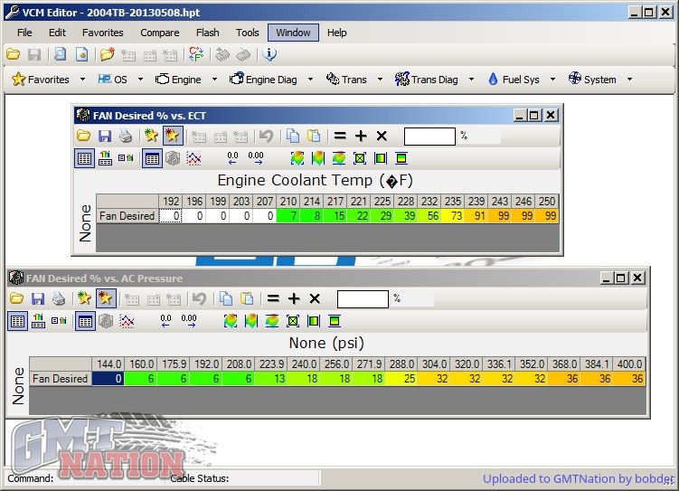

Your temps are fine. The fan is only at 50% at 230F, FWIW. Keep engine temps under 235-340, and trans temps under 235 or so, and you'll be fine, especially if you're running Dexron 6 or a full-synthetic trans fluid. What trans temps were you running, or do you know? I'd be towing it in 3rd gear, so the TC stays locked up a lot more, it doesn't shift cycle as much, and it flows more oil and coolant.
