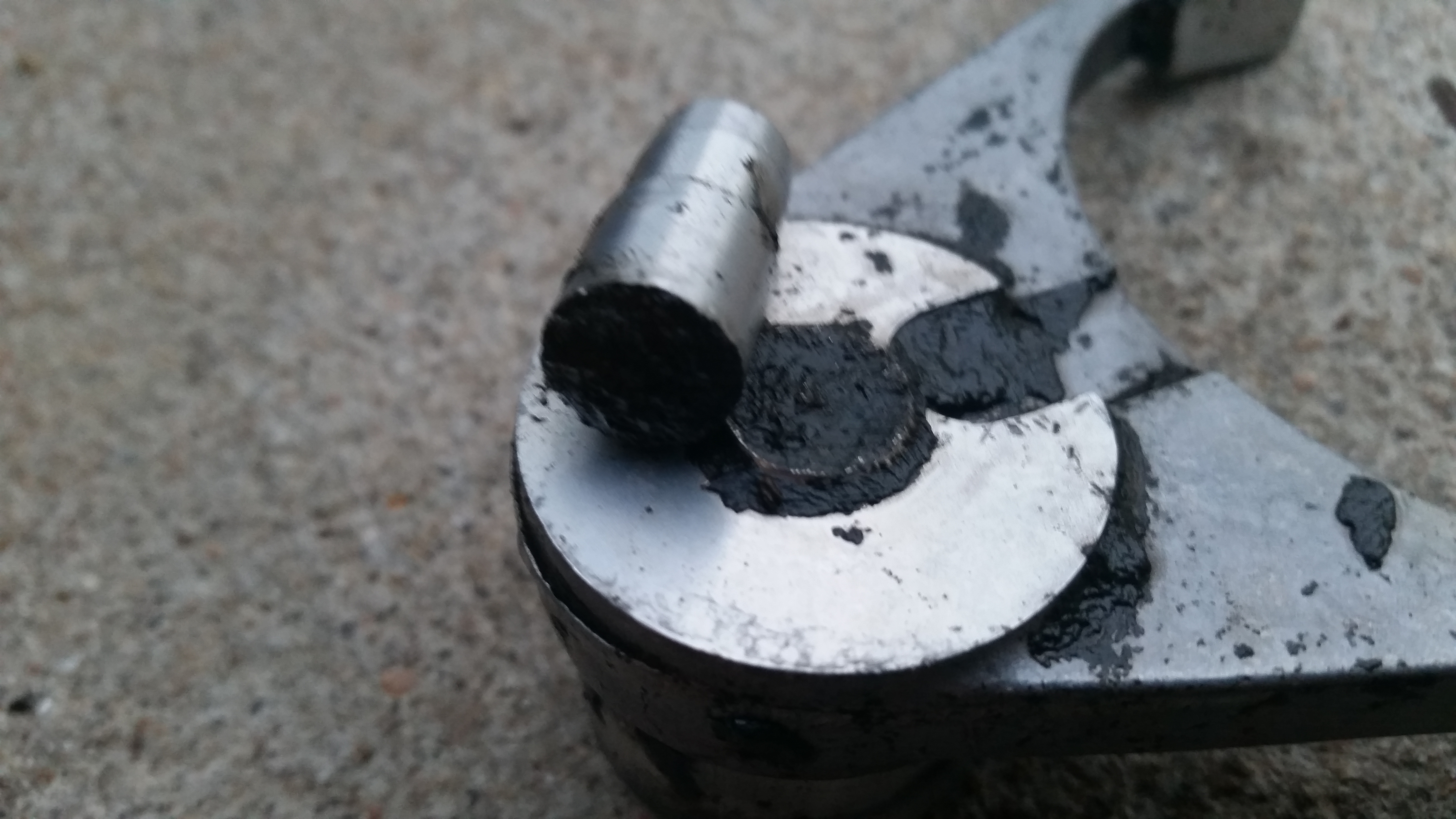

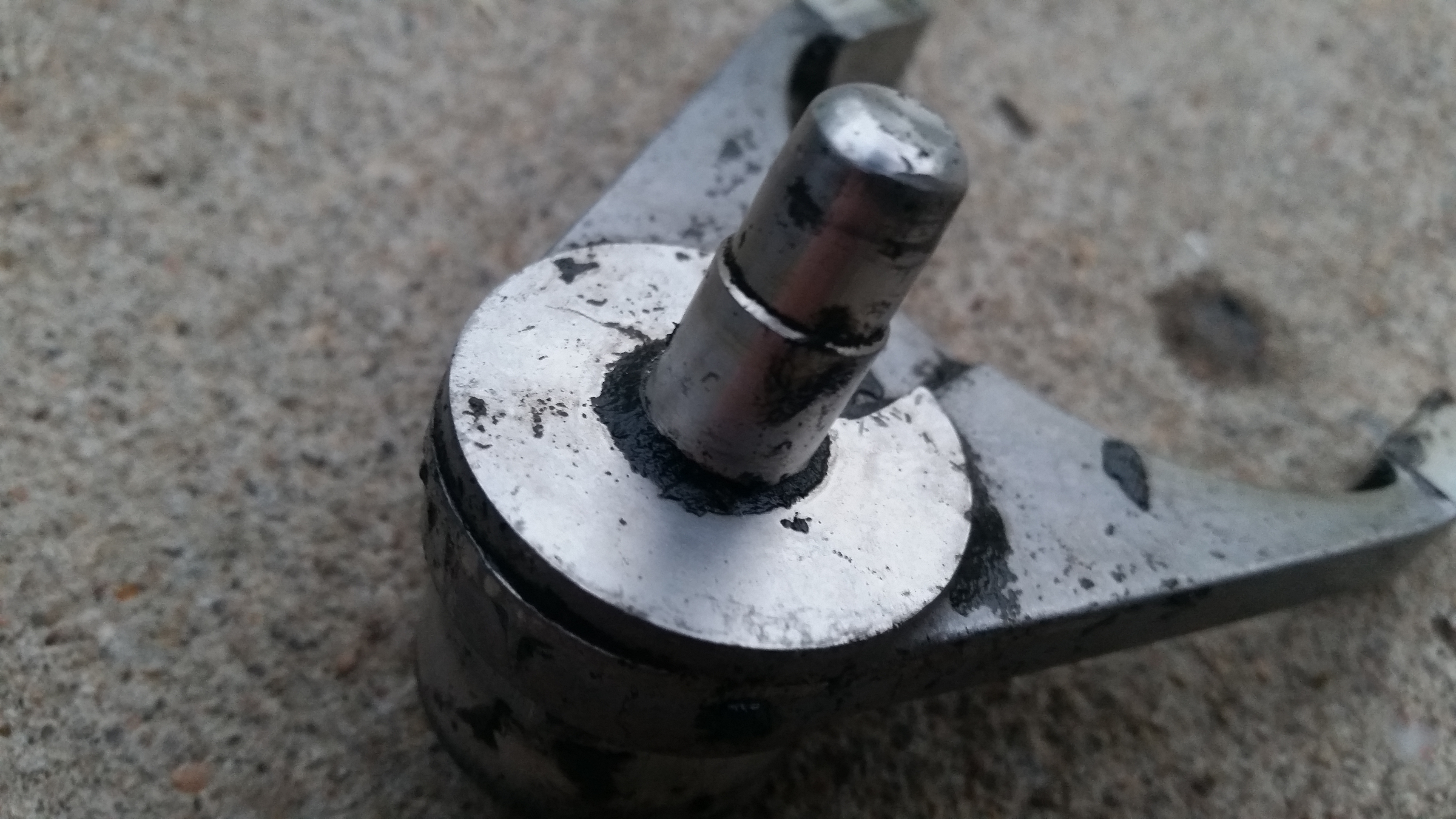

Alright guys... I lost my 4x4 yesterday to the fracking aluminum shift fork in the disconnect. Bearings in it got destroyed on the way home from the internal shrapnel, so if I hit 30+ MPH the CV started flopping around so bad I thought I was gonna crack the oilpan. I've got it taken apart in the garage right now, but I NEED it back as soon as possible.
My question is, what is the best thing to do now? I've seen where people have replaced the fork/bearings/seals in the disconnect and slap it back on, or buy an entire "improved" version of the disconnect off of amazon/ebay, or totally forgo the fork and use the AWD sleeve/weld the gears together.
I don't want to keep going through this PITA bearing-hungry disconnect rebiuld... I like the idea of leaving the fork out completely, but then my 4x4 isn't selectable... right? What EXACTLY would be the result of me using the AWD sleeve? Wouldn't that make it permanently 4x4, not safe to drive it on roads? This IS my DD, so permanent 4x4 is not an option...
