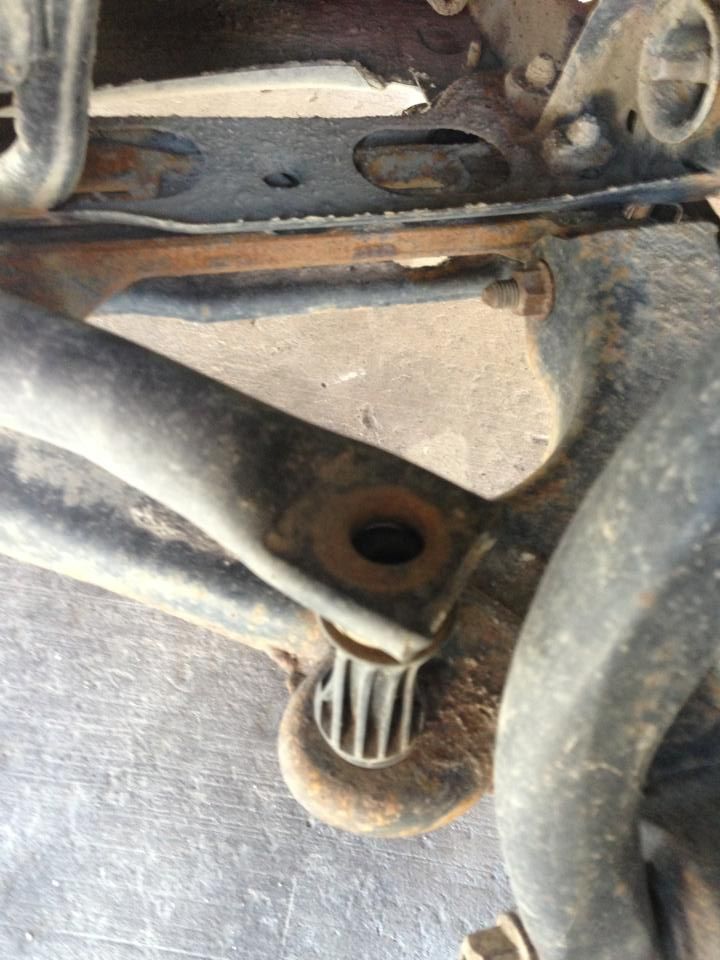

So my 2008 TB front sway bar doesn't have links that mount on the ends ... has a stock plastic type bar that mounts through the top/bottom.
Anyone have any suggestions on replacing this with something that can disconnect?
Should replace the entire sway bar with one that can accommodate end mounting links?

Are you familiar with the type of sway bar links I am talking about? Do I need to post a picture?
They aren't like the ones that came on the early TB's. That is one of the reasons I am considering replacing them.
The sway bar that is stock ... won't accommodate end mounted links (I think ... that is why I am asking here to see if anyone with a newer model TB has replaced these links).

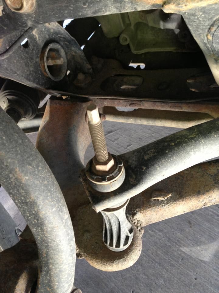

Here is the stock 08 ones.
They do have a quick disco for this style end link. Let me look for a picture.

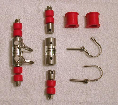

And you'd want something like this for quick disconnects.
I'd imagine these would be fairly easy to make or at least emulate.
A piece of all thread
Some steel bar
Some steel tube
4 pins
8 bushings
8 washers
4 nuts.
Cut the all thread to make 4 studs. Weld the 4 studs to 4 pieces of the bar. Drill pin holes in the pieces of bar. Now you have you permanent pieces. You could use an allan key or small screw driver through the pin hole to hold it while you tighten the nut. Use a ny-lock nut.
Now take the tubing and make the removable center pieces. Cut to length and drill pin holes in the appropriate places. Install on the truck, Install the pins.

I'm thinking the GM change was because they had YEARS of customer complaints about the crappy lifetime of the old end link design. Keeping the force in line with the mounting axis is just mechanical common sense. You have the far superior design and it should be easier to fab up disconnectable links. I was just thinking that 2008 might not have so much aftermarket support for the new LCA design, but I was amazed to see it's the other way around. 2002-2007 LCAs are $100-150 at rockauto, but 2008, with the only change being the anti-sway bar bracket design (I think that's the only change) are around $90! With inner bracket and ball joint pre-installed. Man, if I ever need another LCA, I'm getting the 2008 style and the anti-sway end link can sort itself out. What a deal.

Nice pictures of the disconnects. Looks much more professional than something I could turn out.
I did see some replacement links online that were pretty much all-thread with some bushings ... no disconnecting though.
Are those pics for a TB part or from another vehicle. I might be interested in purchasing some of those.

mtb34 wrote:Are those pics for a TB part or from another vehicle. I might be interested in purchasing some of those.
They're not for a trailblazer and as far as I know nobody makes a dis-connectable sway bar end link for 2008 trailblazers.
I think they are for a Toyota or something.

If the overall lengths are close enough, and the thread will fit through our hole, then it will work for your truck.
