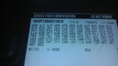

:facepalm: Ok I need Help!!! I am trying to figure out what springs I have and I am not having any luck. The RPO Codes I have are 6SR and 7SP.......
Here is my entire RPO and VIN if anyone can help.

by rgraboske » Fri Nov 25, 2011 10:52 pm
I started to put together a list before compnine went down. I don't have all of the codes, but I have a lot.
7SP is the 1512883. I can't find 6SR on my list.
