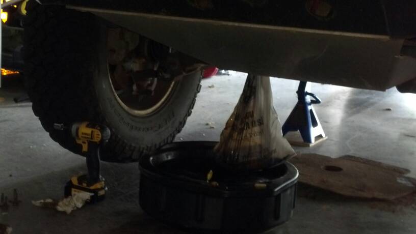

by Trail X » Tue Sep 03, 2013 10:50 am
The key is to wrap it in a plastic bag, and hang it from above, through the handles. Then unscrew the filter, let it drop into the bag, and lower the bag to the ground.

by Trail X » Tue Sep 03, 2013 11:26 am
I just hated getting oil down my arm and shirt.

by TBYODA » Tue Sep 03, 2013 9:49 pm
JamesDowning wrote:The key is to wrap it in a plastic bag, and hang it from above, through the handles. Then unscrew the filter, let it drop into the bag, and lower the bag to the ground.
That is very good idea James never thought to to that. I hate that part also. But as of late I have be lazy and having my cuz shop change oil on my cars.
