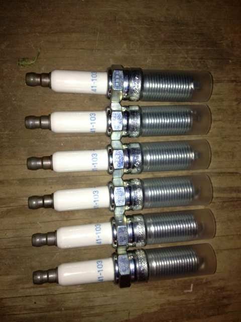

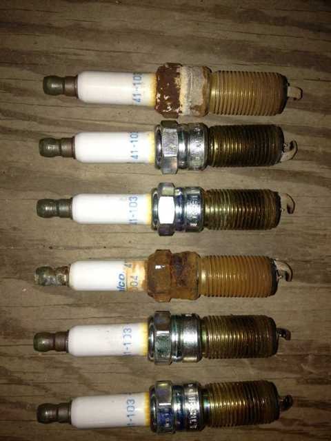

2006 Trailblazer 4.2 137,xxx miles was throwing P0300 and P0304 codes, just changed plugs with new 41-103s and now it won't run. Cylinder one an 4 showed significant corrosion.

1 and 4 do look pretty rough lol
It's peculiar that it wouldn't run at all after the work. Are you sure you got the coil packs pushed down on the plugs?
The resonator really should be connected so the MAF will measure the incoming air. There's also a major vacuum leak with the front hose (i believe it's the pvc system) on the resonator disconnected. With the TB being disconnected from the intake resonator it may also have trouble controling the idle air mixture. Hook everything up like it's suppose to be and try again.
My WAG is this is the problem.
