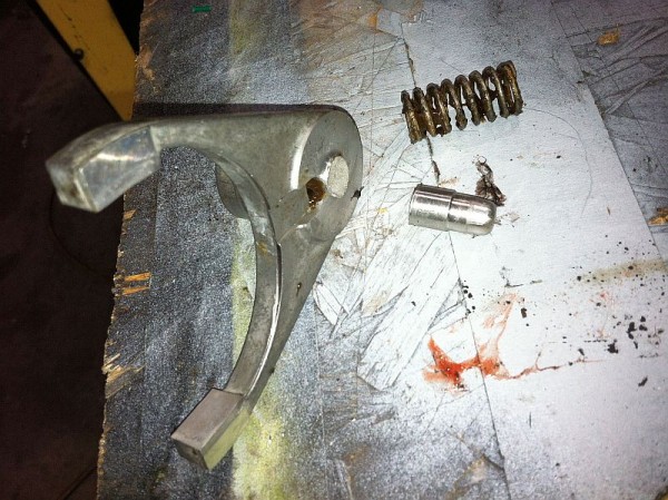

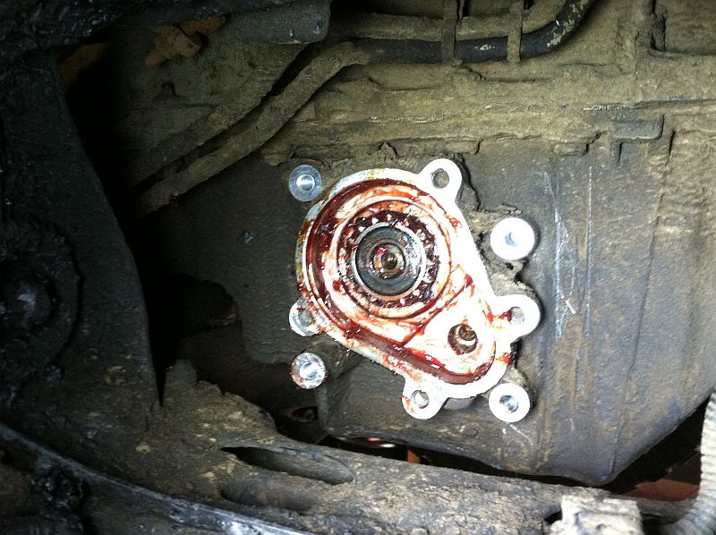

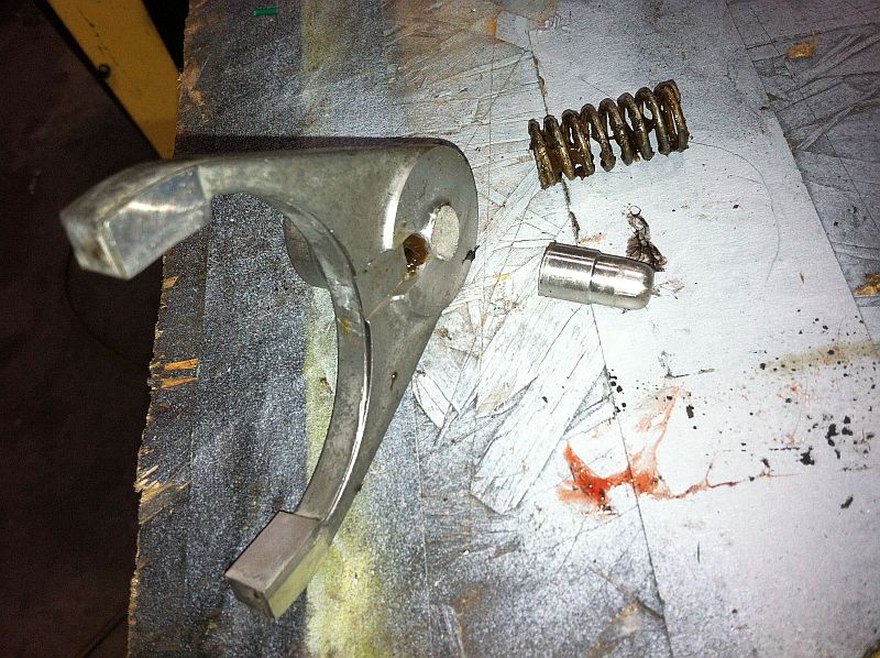

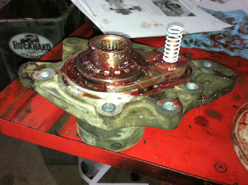

by steveroche » Sun Nov 18, 2012 12:43 am
Here you have some pictures of the action. I sheared the shaft on the fork causing the 4wd to not engage correctly and cut out on me as well. After removing everything and cleaning all the bad grease out and checking the gears I also checked the bearings which were in perfect condition so there was no need to replace those, or the axle seal. So I lucked out with that. No cracks in the case either, I took off half the case and left the other half on the truck. It was nice to be able to use the shop to work on it instead of my driveway...makes a world of difference being in a nice shop with a lift, more tools and access to extremely intelligent and knowledgeable mechanics who can help me when I need a second opinion. Overall, I am very happy with how today went and now all I need is new tires and i'll be all set for the winter!
