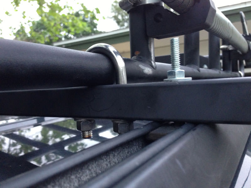

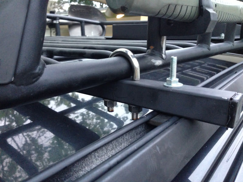

by mikekey » Thu Apr 11, 2013 7:33 am
First, my wife built this yesterday when the original idea didn't work.
Two 48in x 1 1/4in x 1/16in square steel tubing. The plates in the roof rails are 1/4 steel plate with a hole drilled out and a carriage bolt thru it which has it's head welded to the plate. And of course, 4 u-bolts.
It's solid enough for me to stand on. :friday:
