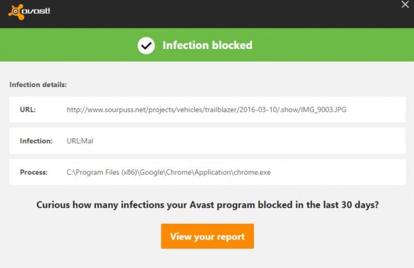

by Regulator1175 » Wed Mar 16, 2016 1:29 pm
I can't see the pictures, I keep getting a virus alert for this thread. Anyone else getting the same thing?
by Shdwdrgn » Wed Mar 16, 2016 2:18 pm
You know, somebody on another forum mentioned that recently. They were running Avast and getting a warning because my domain name is "sourpuss.net". It would be nice if they published some info to tell me what they *think* they found so I could look into it, or if they're just upset about my domain name (I've seen quite a few emails rejected for X-rated content because "puss" is in the name).

by HawkeyeC25 » Wed Mar 16, 2016 2:19 pm
Regulator1175 wrote:I can't see the pictures, I keep getting a virus alert for this thread. Anyone else getting the same thing?
Nope, pics look fine for me.

by Regulator1175 » Wed Mar 16, 2016 2:53 pm
This is what it is giving me.

by Shdwdrgn » Wed Mar 16, 2016 3:41 pm
Regulator, thanks for the screen shot. I sent a report to Avast to fix their shit (I used nicer words), will see what happens. I've been posting images from my domain to forums for years, never had this come up before.
