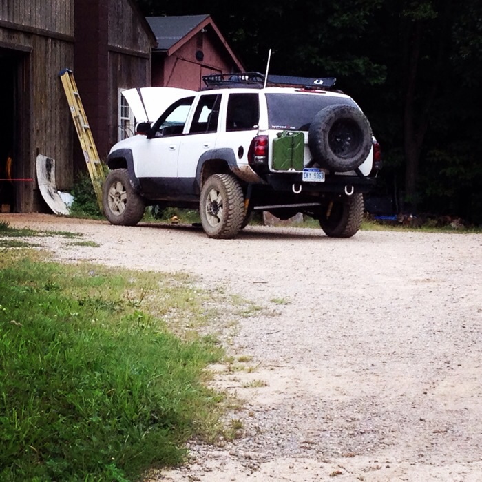

:excited: the trailblazer is up and running again!!! We did end up rebuilding the pump. All is good runs and drives as it should. So I of course had to take it to the trails! Started putzing around the field and noticed the temp was hot as shit! My damn fan clutch went out so I whipped in an e-fan wich surprisingly enough make the TB run cooler. Temped it in last night and really re mounted it today. I would like I thank you guys for your help and input.
and I have also discovered a lurker by me. He was out with me last night too.

by ErikSS » Thu Aug 28, 2014 1:49 pm
Pics or it didn't happen.
by Cable810 » Thu Aug 28, 2014 3:59 pm
It happened he texted me pictures.
by ErikSS » Thu Aug 28, 2014 4:40 pm
Cable810 wrote:It happened he texted me pictures.
I'm not sure how pictures he texted you are going to help the rest of the Forum. Considering the cooling issues our trucks are known to have, all documented success stores are great!
Did you just put a toggle switch in the cab for turning it on and off?
