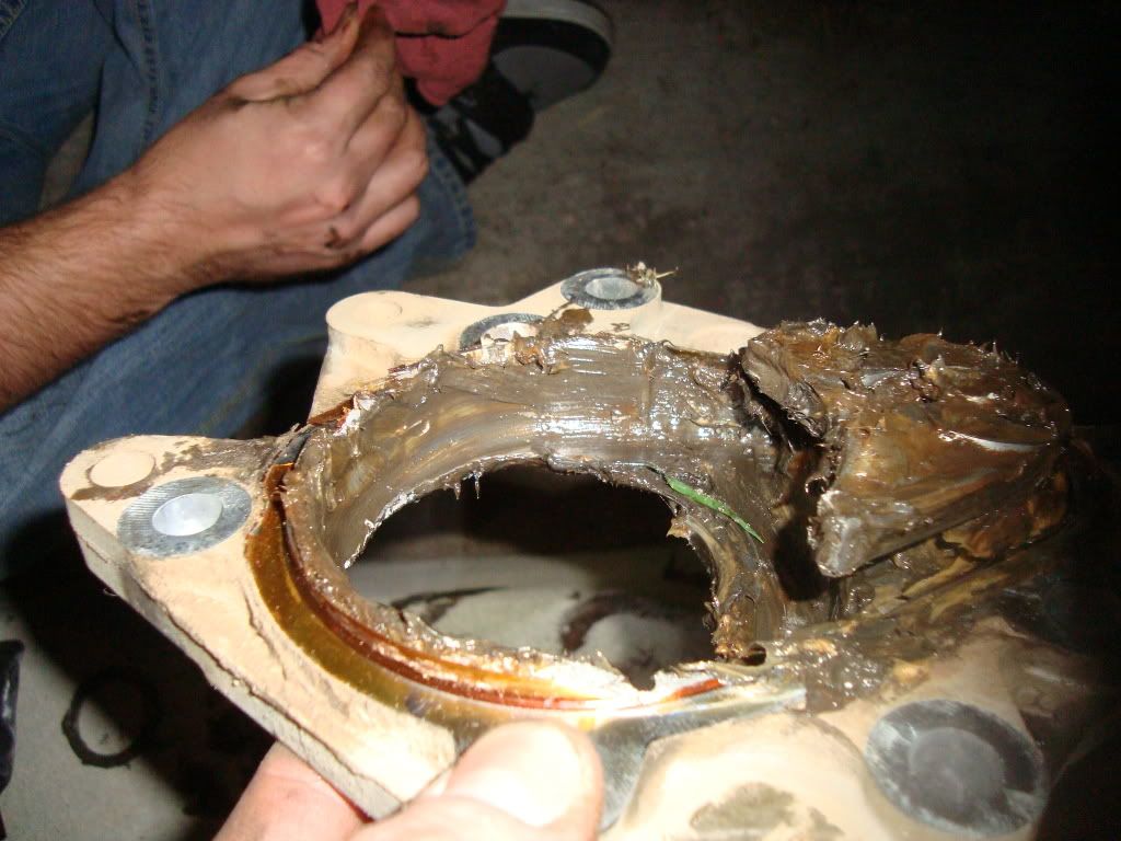

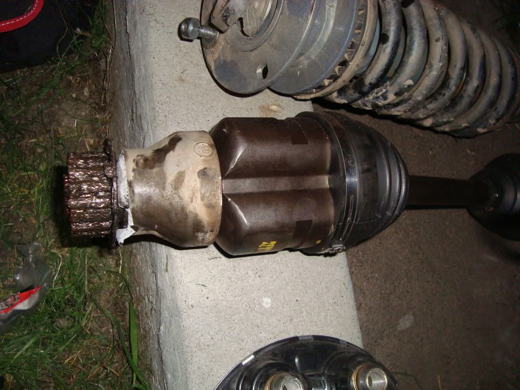

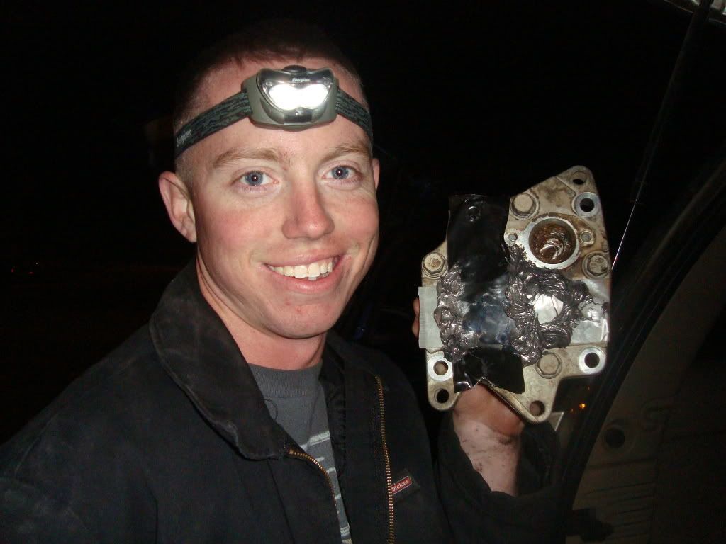

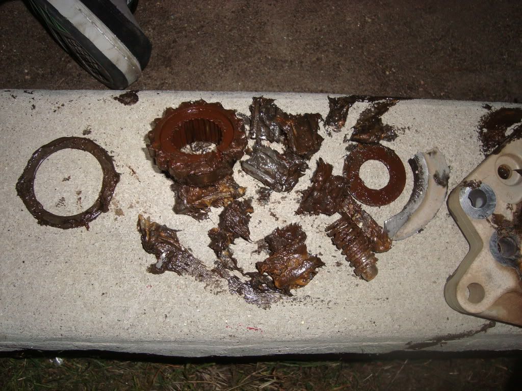

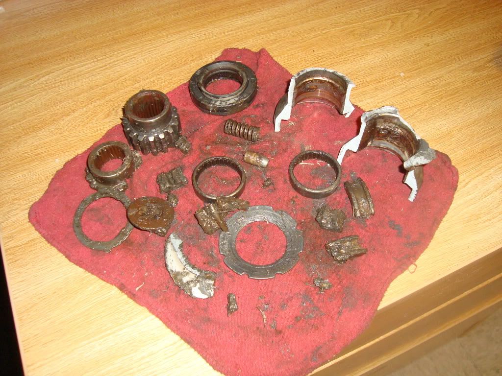

by DirtyBacon04 » Fri Dec 23, 2011 2:44 am
OK!! Here are the pics... (not sure why i'm so excited about this devistation)
My retard smile with the completed tape/rtv job to seal up the huge hole
Lucky for me, the brand new CV shaft was not damaged.
by fishsticks » Fri Dec 23, 2011 2:48 am
Impressive. My gears were in more pieces than yours, but all in all that's what my innards looked like.

Wow, that's more destruction that I expected. Looks like the initial failure was the syncro/sun gear, which I'm guessing then got caught in the inner gear's teeth and wedged between the gear and aluminum housing, which then blew the housing apart.
I'm guessing Bill is right that it's mainly due to excessive wheel spin and the deceleration that the drivetrain goes through when the wheel touches down on terrain.
Ouch.
