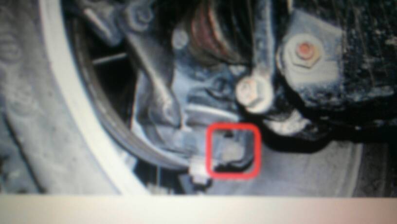

by ErikSS » Sun Dec 15, 2013 11:00 am
The "trick" with the lower is the location to smack it. The lower control arm must be bolted to the vehicle for it to work as you're using the vehicle as a shock point. On the inside of the knucke where the LBJ coes through you will find a raised fin shape that protrudes in a strange way. That's the part you need to smack. Your hammer will be under the lower control arm swinging towards the outside of the vehicle. It is where the LBJ is held in place. Pretty much all tapers have a place intended to beat on them.
In James case, not knowing this trick combined with 150,000 miles and a ton of offroading would make things Much more challenging!

by ErikSS » Sun Dec 15, 2013 11:18 am
Sorry about the poor pic quality... But this might help
