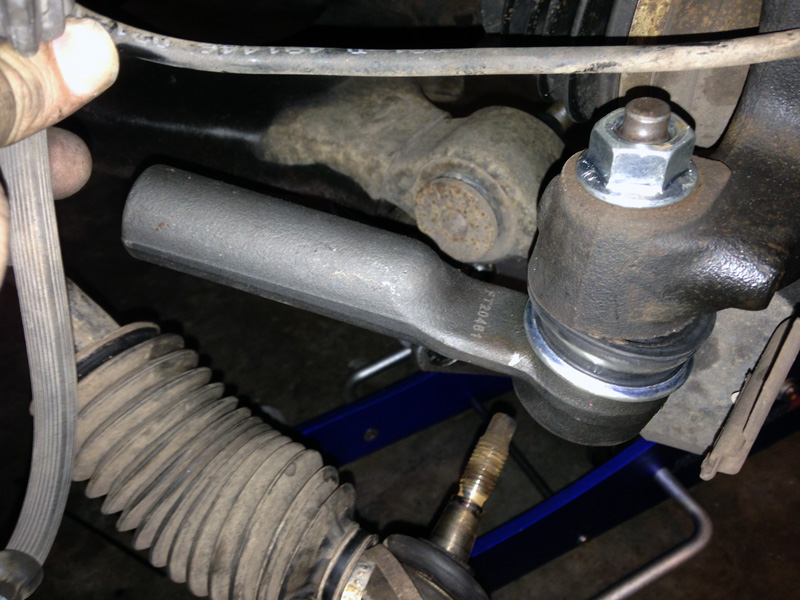

Well looks like my HD tie rods are going to fit so far....
by blazinlow89 » Sat Dec 07, 2013 2:28 pm
Are the HD tie rods any longer than stock.

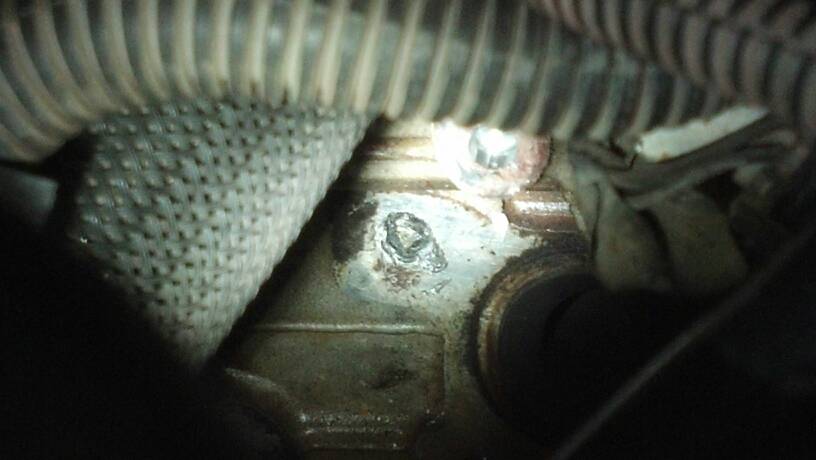

by Trail X » Sat Dec 07, 2013 6:36 pm
This was fun... x2...
by mikekey » Sat Dec 07, 2013 6:45 pm
What in the world is that?
by dvanbramer88 » Sat Dec 07, 2013 6:49 pm
broken exhaust manifold bolt?
by Trail X » Sat Dec 07, 2013 7:41 pm
Yep... two of them. Biggest pain in the ass in a while. I almost gave up.
by Wahugg » Sat Dec 07, 2013 8:59 pm
How'd you end up getting them out? Right angle drill?

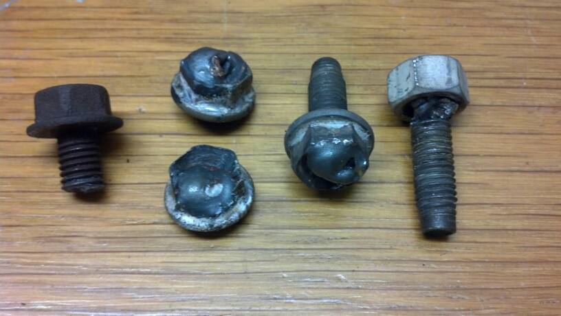

by Trail X » Sat Dec 07, 2013 10:20 pm
Welder. You can kinda see the progression in the image here. At left is one of the broken heads. That one broke inside the head by 3/16in or so. The other wasn't as bad and had one exposed thread, but its resting on my skidplate right now. In the middle of the picture are two of the weld attempts I made that didn't hold up. Basically, I took some nuts and counter sunk one end, so I could reach in there easier to weld the nut onto the stud. My brother had to hold the nut in place while I tacked it. The one that broke inside the head had to be built up by bumping weld into the hole until I could build up enough steel to weld the nut to. On the right are the two extracted studs, welded to the nuts.
by dvanbramer88 » Sat Dec 07, 2013 10:23 pm
JamesDowning wrote: The one that broke inside the head had to be built up by bumping weld into the hole until I could build up enough steel to weld the nut to. On the right are the two extracted studs, welded to the nuts.
In this situation, you can put a bog flatwasher over the hole, and pump weld into the hole welding the washer to the bolt stud. than weld the big nut to the washer. But anyway, this welding a nut over the broken stud method is supposed to be a decent way to do it. I've heard of it working a lot.

by Trail X » Sun Dec 08, 2013 12:02 am
I was pretty ginger with it, didn't pump the weld in. No washer for me, but I can see how that might make it a little easier. With a small diameter threaded nut, its a bit tricky getting the plug weld to hold... well at least for me it was. I was hugging the front suspension when I did it, looking through a small hole between the body and frame while welding.
by dvanbramer88 » Sun Dec 08, 2013 1:05 am
The guy I saw do it, did it on a full size pickup, took the whole inner fender out, and had all the room in the world.
Least you got it out though.
by Trail X » Sun Dec 08, 2013 10:49 am
The one that got it out was my absolute last try. I was going to just put it together without the bolt. My brother actually talked me into trying it one last time.
