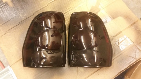

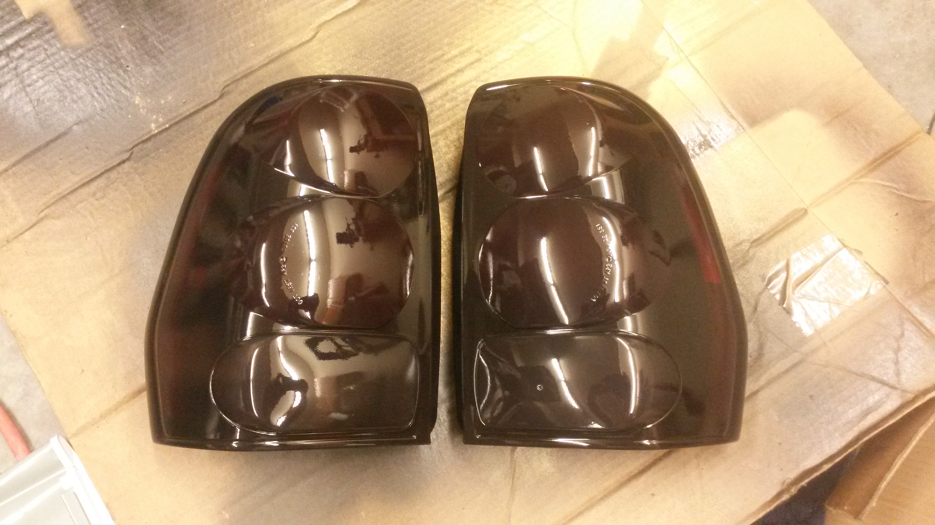

So, just wondering what opinions you guys have about the tinted lights. Personally, I think it looks really good. Does anyone on here have theirs tinted? I've been reading about it, and it seems that a lot of people say it has little to no effect on your light output as long as you use the right stuff. I'm talking about spray-on too, by the way. Here's what I would probably use if I did this. Included 2 ex. pics I found on Google also. Any thoughts? :poke:

As an electrician, I'm skeptical about any film being applied to a bulb or housing with claims that it doesn't affect light output.
I mean, just think about it, even those crappy faggy blue tinted bulbs are dimmer than regular clear ones. Maybe not by much, but it could be enough to see the deer in the road in time...
That being said, I think they look awesome.

by DirtyBacon04 » Fri Oct 30, 2015 5:42 am
As someone who isn't an electrician and is terrified of working with it.... I also think they look good, but may hinder functionality. I'm willing to bet those who claim it didn't effect light output didn't do a very scientific study. Then I'd be curious as to how long before the film burns off in spots.

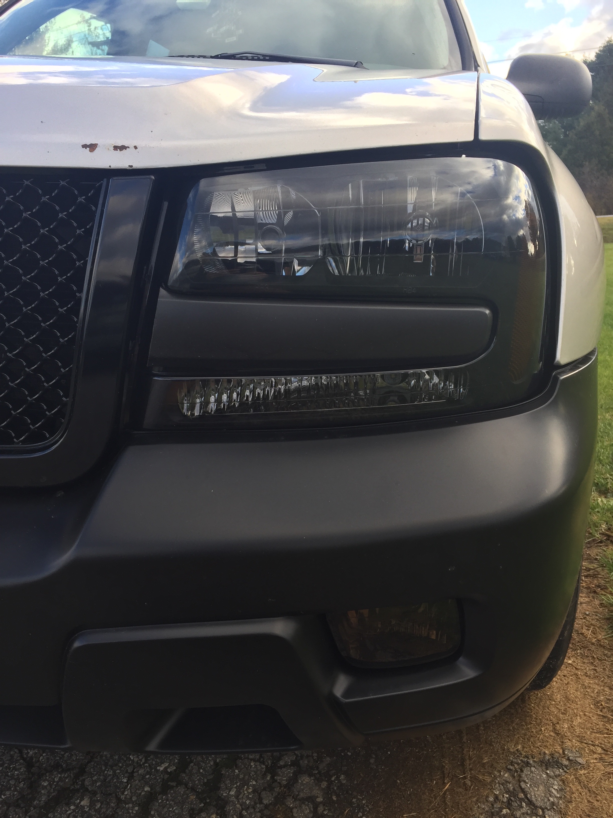

Here's what might looks like. The only con of the tinted headlights to me is my marker lights don't show up that great, which is now my front blinker haha... And im too stubborn to connect the blinker back up because I want it to be a daytime running light, not a white blinker. I also have my fog lights tinted. Let me know how it goes if you do spray it on youself. Because if you can see, my fog lights have a brownish tint to them and if spraying the tint on is easier and looks better then I might just buy clear fog lights and spray the tint on!

This looks like more of what I'm aiming for. I just want the lens a bit darker, but not as dark as the average tinted headlights you'd see driving down the road. Thats why I want to spray it on myself, so I can control just how dark it gets. Thanks for the replies everyone

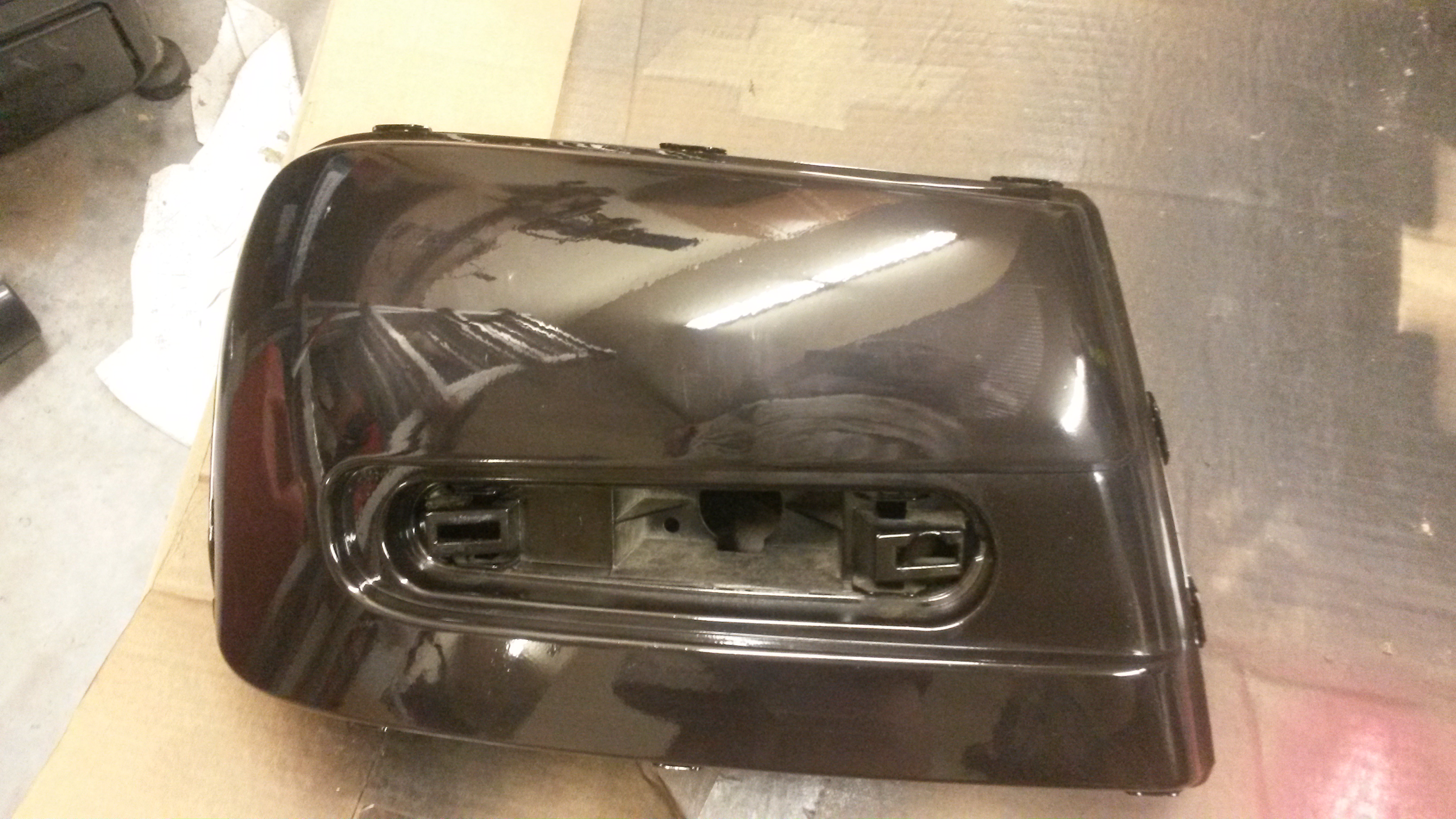

alright, so, word of advice. DON'T DO THAT. tried using rustoleum tint and it worked great on the tail lights, but once I sprayed it on the heads I know it would be way too dark. plugged it in while it was still wet, and could barely see any light on the wall 30 yds away. ran around looking for something to get it off with before it dried on good, and the ONLY thing I could find in time was acetone. DO NOT LET ACETONE TOUCH YOUR HEADLIGHTS. I got it off fine on the driver's side, but the acetone ate right into the lens on the passenger side. looks like someone took a sandblaster to it. I'll upload a pic tomorrow. looks like I'm gonna be buying new headlight assys. smh.

the after math. looks like new head assys is going back up on the Christmas list. Image

WOW... That's why I usually just buy the stuff or have backups ready. But the tailights look good! I would be willing to send you my factory headlights which are in no use.. But, I kind of used the passenger side as a "experimental" headlight :/

you try some 1000 grit sand paper and rubbing compound yet? you may be able to buff it back out.
