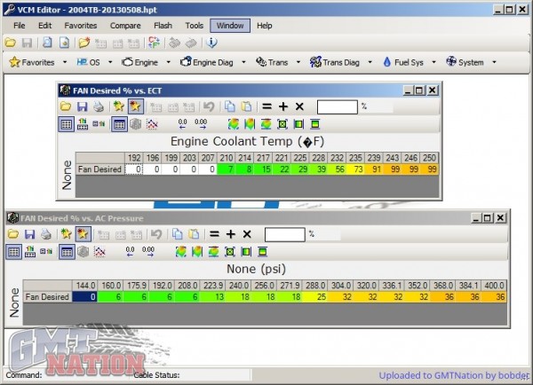

No, it comes on linearly, and later than you'd think. You didn't happen to have a SES light, did you?
Have you at all recently cleaned your radiator and condenser?
https://www.youtube.com/watch?v=ETsia8XD5rk
It's not out of bounds for a new or fairly new fan clutch or thermostat to be out of spec, either. In fact, my AC Delco replacement thermostat tended to make the coolant temperature walk up and down 15-20 degrees, on the highway, for no apparent reason.

Cool thanks, guys. I will take the cheaper route first. What program is that?
