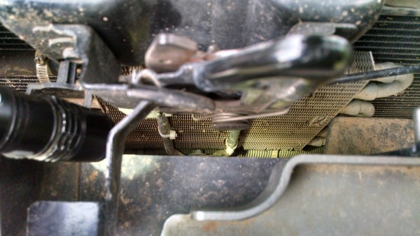

I mounted my tranny cooler to the front of the a/c condenser directly in front of the fan. Zip tied it to the hood latch supports.

by KingBird » Tue Oct 20, 2015 7:22 pm
Sure thing, the trick is to get it tight enough that it doesn't move, but not so tight that it crushes the heatsink against the support.
Disclaimer: this isn't a proper or professional mounting, but it's good enough for this Texas redneck. :flex dirty:

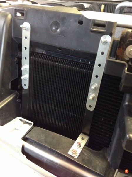

by TBYODA » Wed Oct 21, 2015 12:14 am
Or you could do something more solid like this. ;)
by Rickalicka18 » Wed Oct 21, 2015 12:40 pm
Ahh yess those both look like good locations! I need to do that soon haha

by KingBird » Thu Oct 22, 2015 4:47 pm
Hey, it doesn't bother me. I can over-engineer stuff, I choose to do it when it matters. I can tell you from having the same cooler on my Corvette for over 12 years that it doesn't matter how it's mounted as long as its not directly against the radiator/air conditioner condenser and it has airflow.
