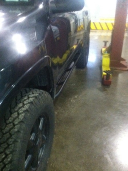

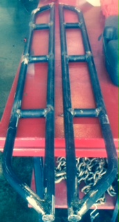

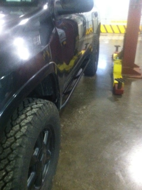

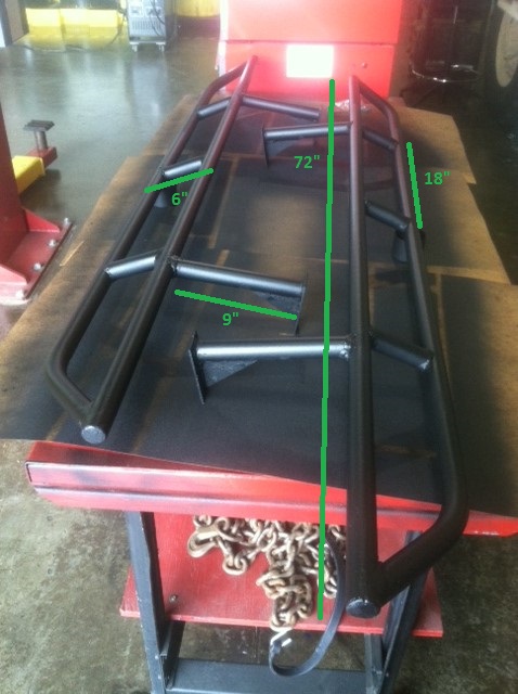

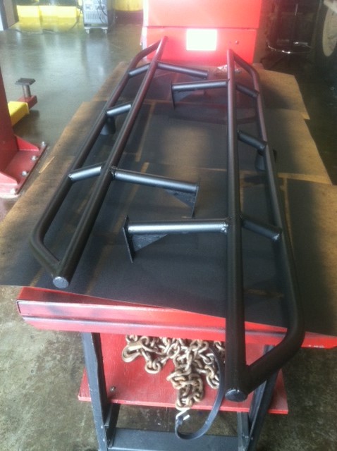

Had some pipe and some time so i made these up, they came out good i think.

by The Roadie » Fri May 23, 2014 10:50 am
Nice! Nothin' says "I'm going to bang on some rocks and make noise" like rock sliders. Were they DOM or normal pipe? Specs?
by charliedeuce » Fri May 23, 2014 12:31 pm
Pipe was just steel 1-1/4 OD - 1/8 wall tubing. I could have made them a little longer but im happy with em.

by Trail X » Fri May 23, 2014 1:28 pm
So, black pipe is what you used?
Without looking close at the welds, they look pretty good.
by ErikSS » Fri May 23, 2014 2:26 pm
They look good. My Trailgear are 1/8" x 1 3/4". How did you make the bends?
by charliedeuce » Fri May 23, 2014 3:19 pm
Trail X wrote:So, black pipe is what you used?
Thanks, Not black iron pipe like yr thinking lol. Its structural steel pipe, But I dont know why is was already black.
ErikSS wrote:They look good. My Trailgear are 1/8" x 1 3/4". How did you make the bends?
Thanks, At work i have one of thoes PITA tube benders that goes on yr shop press. Im not a fan but it gets the job done.
