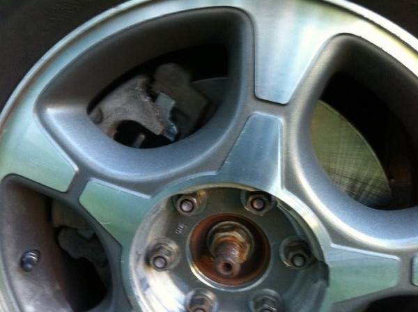

To get started pick a side and remove the wheel and the caliper along with the pads. You can set the caliper aside out of the way.

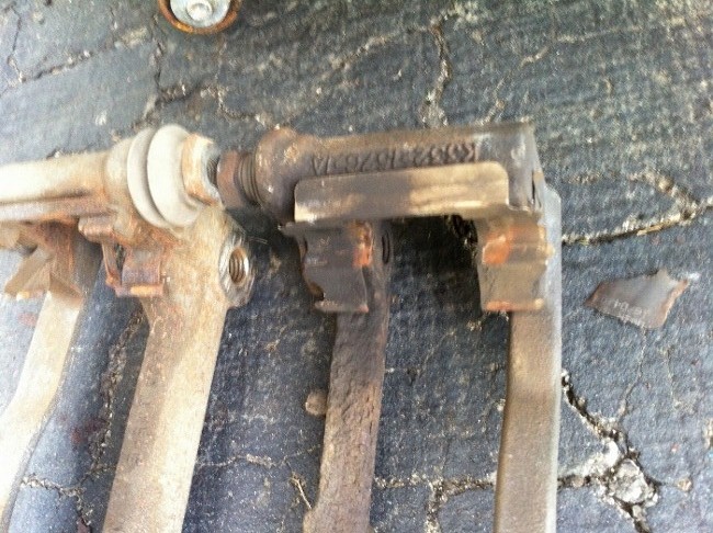

Then you'll have to remove the two 17mm bolts holding the bracket in place, as shown here:

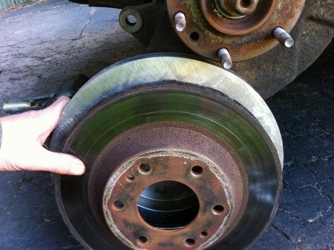

After the bracket is off, the next step is to remove your rotor. If you end up like me, you'll have these annoying metal tabs which have to be removed first. Then the rotor will pull straight off.

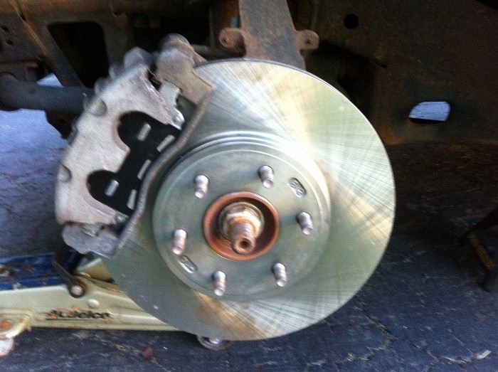

After that, you can put your new rotor on, and then install the new bracket where you removed the old one using the new caliper guide pins and boot kit.
It really is that simple. Next up, replace your old pads, now is a good time if you want to paint your calipers. I decided why not.
Re-install your caliper using the new bolt kit. A little blue loc-tite might be a good idea.
And that's all. Incredibly simple, and an effective upgrade.

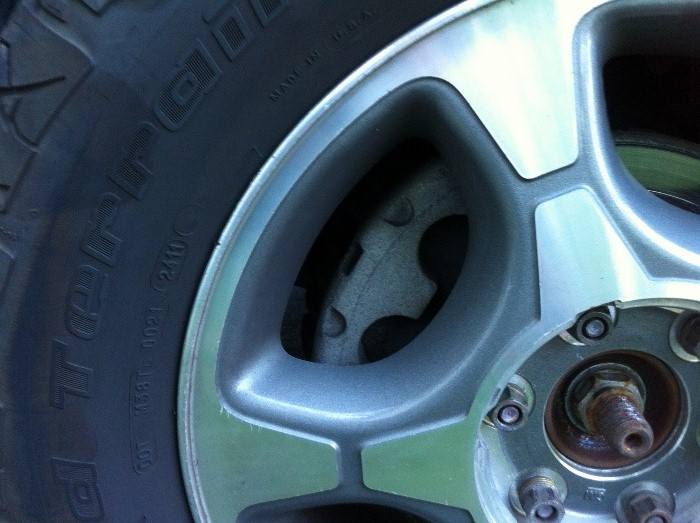

by jonbo2002 » Sat Sep 14, 2013 9:08 pm
oh and to show spacing difference on 17s without spacers
