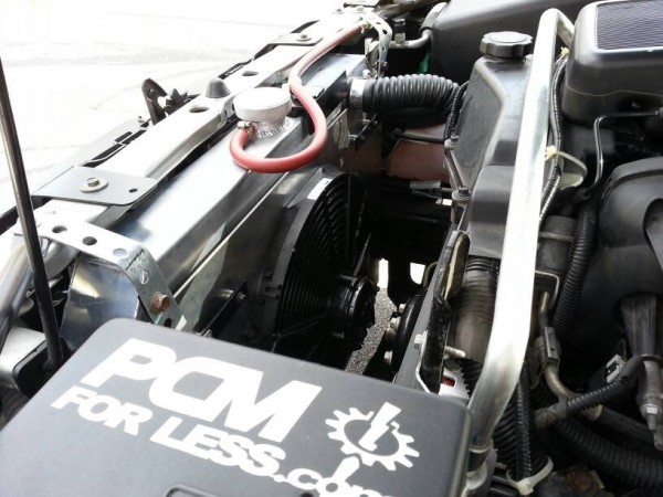

Allow me to be the next runner up. Using the PCMofNC efan kit because I already had it and figured I'd try it before dropping cash on the stuff for a Derale setup. I'll edit this post on my compute later with links and proper dialogue. ImageImageImageImageImageImageImageImage
| Mason | | | |

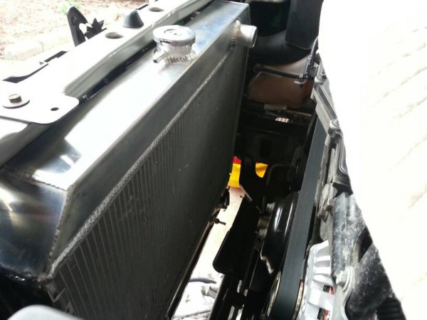

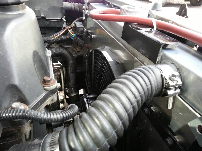

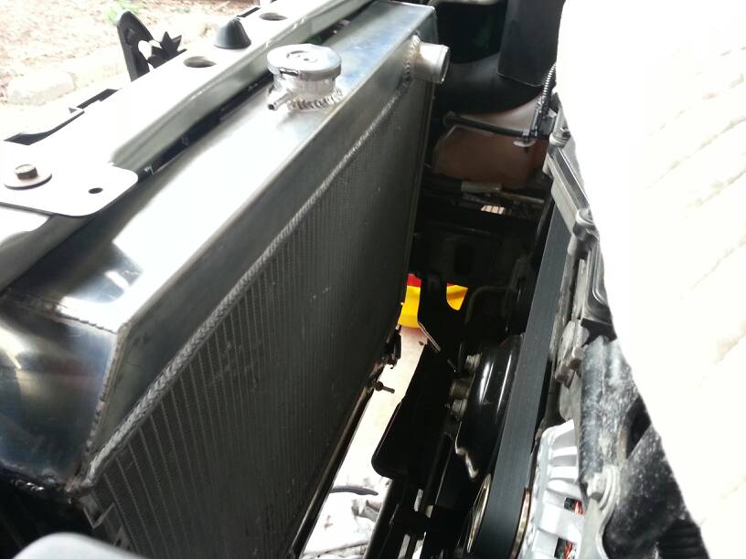

by mason10198 » Sat Aug 11, 2018 2:44 pm
So... I got the radiator installed, with the PCMofNC efan kit, 180 degree thermo-switch on the rad output controlling the fan. Now, truck runs hotter than it did with stock rad and same efan. Overheating on highway if AC is on. I guess the efan isnt good enough? Bad shroud design blocking too much airflow? I'm using the exact same rad as Jon, so it shouldn't be the issue. Coolant thermostat is new and working. Holds 200 at idle in 80 degree weather. Around 215 driving without AC. Got up to 230-235 with AC on highway.
The way I rigged the shroud on the rad, it's only spaced back like half an inch from the core. I did my best. Anyone got any thoughts, other than just get better fan(s)?

by Flyingfischer5 » Sat Aug 11, 2018 3:24 pm
When I first installed my efan kit way back in the day I was having overheating problems as well while driving. I used a 4" hole saw and cut holes in each corner of the fan shroud to let air flow through while driving. Works awesome now and holds around 200 sitting still or driving. It may not be the right route but it worked for me and haven't had a over heating problem since doing it. I'll go snap a pic of what I did.

Here's one other thing I found strange. After driving it around and getting it hot, and then parking, I was feeling the air coming out of the fan, and the air coming from the passenger side half of the fan is hot, as it should be, but about 3/4 of the area of the drivers side half of the fan is blowing cold, normal, untouched air. Both top and bottom tanks are evenly hot across their length.

by mason10198 » Sun Aug 12, 2018 9:00 pm
Welp, always double check for air. I got impatient and only burped it once before driving, and just got another whole gallon into it. No wonder it was running hot LOL.
That explains the uneven temps behind the fan. The water was going into the rad and going straight down on the inlet side, the "cold" side was just full of air. It's evenly hot all the way around now.
