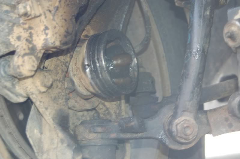

by Regulator1175 » Sun Aug 15, 2010 12:07 pm
Sorry, I don't know the actual terminology for the parts I was referring to. As always, photo evidence is the best so here you go.
Vehicle side:
Wheel side:
I know the wheel side is bolted in. My concern is if the vehicle side portion of the shaft is going to back out while on the trip home or if its solid enough in there that it will stay in place.
by teebes » Sun Aug 15, 2010 12:51 pm
Yuck, that's going to be a bear to remove.
You should be fine to travel with it as-is, in 2-wheel drive. On the wheel side, do you still hav parts sticking out or what does that side look like? I would pull off as much loose items on that side as well.

by Regulator1175 » Sun Aug 15, 2010 1:50 pm
The second picture was of the wheel side. I have basically separated the shaft at the joints on either end.

The inner section near the oil pan is called the tripot or tripod joint (both seem to be valid). It's held into the splined disconnect with a circlip, and the way you have to remove it is with a slide happer, or a long drift punch (I use an 18" length of rebar) hammeres at the BACK of the tripot housing from under the oil pan. I don't think it can possibly back out of the receptacle while you drive.
