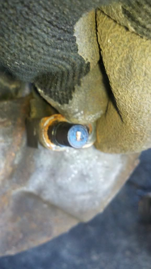

by Opeth » Sat Mar 09, 2013 6:30 pm
Ok, was bored today and tore into the problem wheel sensor.
The cheapie eBay bearing has a poor crush gasket which clearly didn't work...
So I took a wire brush and tried to clean the corrosion off the steel pick up on the sensor and brushed the area around the sensor. Re-installed but lights came back on, I forgot to try unplugging the connection at the body harness to see if that's tight. Went for a drive and all the lights are off for now. I'll see what happens and go from here next.
Edit: well that didn't help either...
