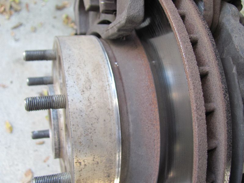

by The Roadie » Sat Nov 05, 2011 6:22 pm
How the wheel moved
Bearing failed internally - will send it back to the vendor for analysis, whether or not they give me a credit. It has a one-year warranty, but let's see if they weasel out of it.

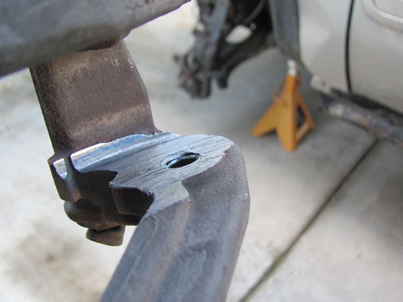

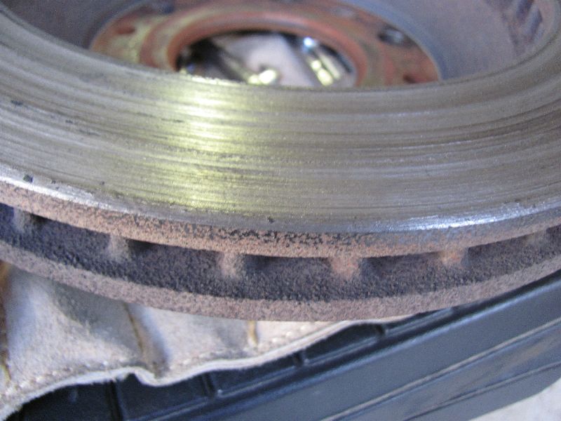

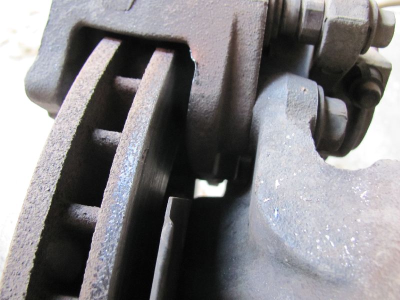

Wheel was kept from falling off the vehicle by the rotor scraping against the inside of the brake caliper - it took about 1/4" of metal off one inside edge. Very similar to the way my broken rear axle was retained by the rear caliper when the c-clip failed in the Montrose, CO incident. Aluminum transferred from the caliper to the rotor and then to the brake pad, so even if I had changed the hub on the trail, it still wouldn't have braked well.
Spacer pushed up into caliper
First hint at where the damage was:
Rotor:
Floating part of caliper:

The Roadie wrote:How the wheel moved
Rotor:
This remind me of how much Matt's bearing was moving when we changed it on the way to Tecore IX. Matt you have other damage like Bill?
