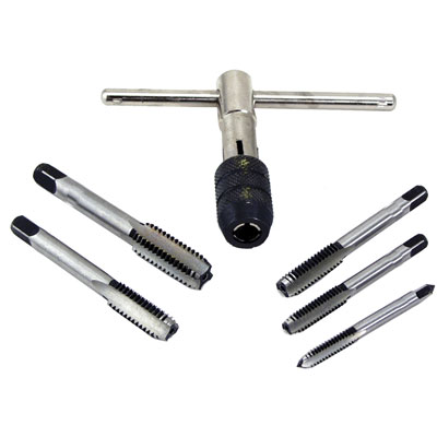

by MrSmithsTB » Tue Dec 21, 2010 5:44 pm
If there is enough of the bolt sticking out, you may want to consider using this:
I know it is a tap kit, but the actual tool that holds the bits should bite on to the bolt enough to back it out of the hole. It is compact, so clearance issues should be nil.
