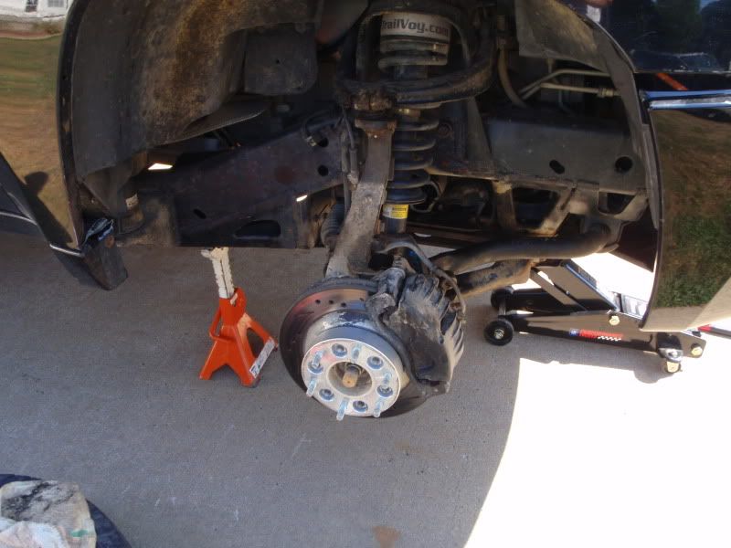

1) set your emergency brake and chalk the rear wheels
2) loosen front lug nuts
3) lift the front end and support the truck on jack stands
4) remove front tires

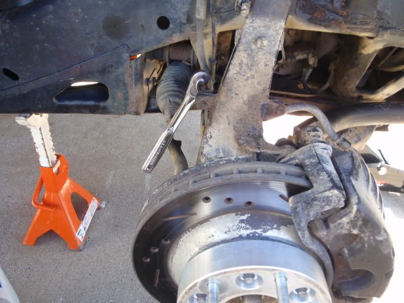

..... a) loosen the two upper nuts (15mm) but do not remove them yet

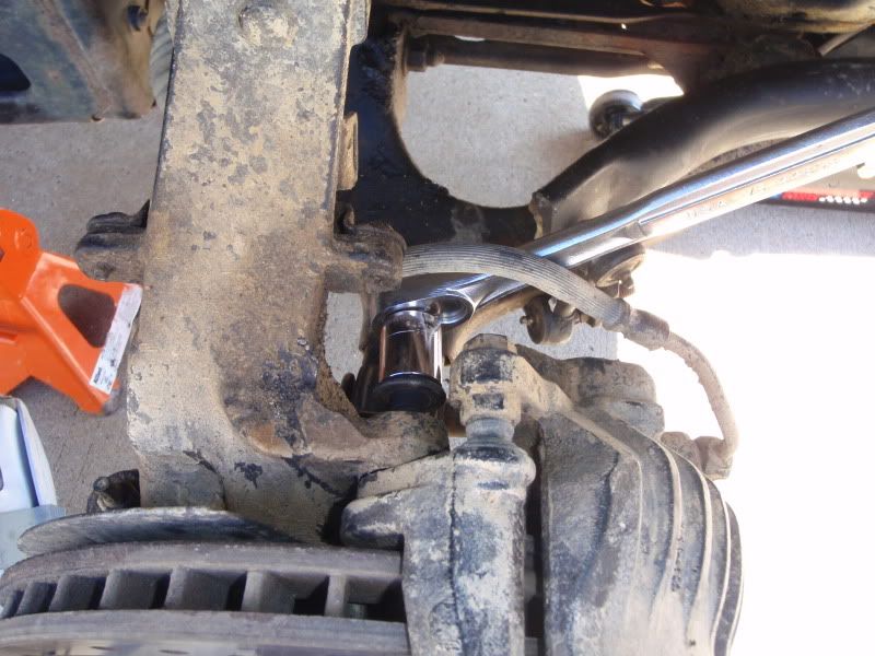

..... b) loosen the lower nut (15/16ths) back the nut off until there are no longer any threads exposed
..... c) lap a pickle fork into the opening between the lower shock mount and the control arm as pictured
..... d) using a heavy hammer hit the end of the tapered post (make sure the nut is to the end of the threads and your hitting the nut, otherwise you run the risk of fowling the threads on the end of the post.) It only take a few decent smacks to get it to pop free
..... e) remove all three nuts and remove assembly

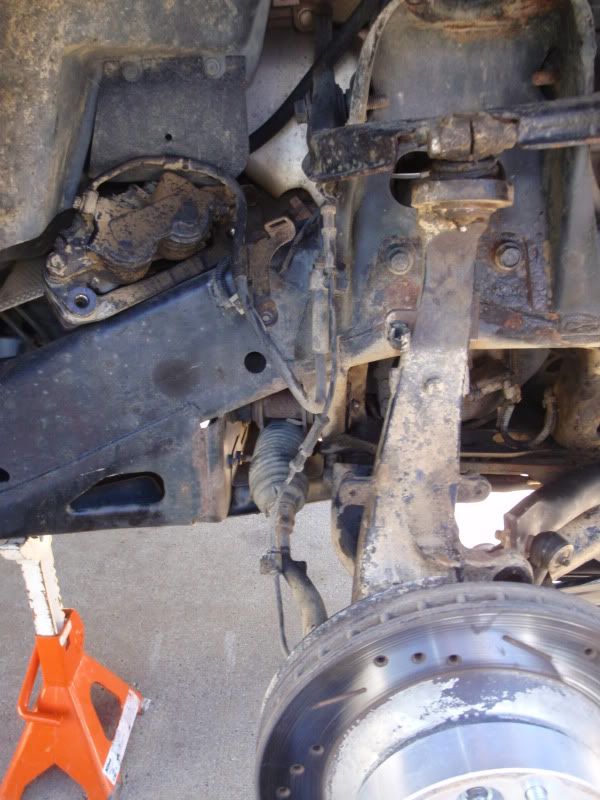

6) Remove the brake caliper and bracket in one piece (18mm)
7) remove the brake line bracket (10mm)
8) set the brake caliper assembly out of the way (I had enough room due to the body lift to set it on the frame, you may have to hang it up out of the way. Be careful not to strain the brake line.)

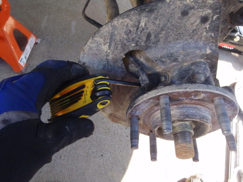

10) remove the speed/ABS sensor (5mm allen wrench) unclip and move it out of the way

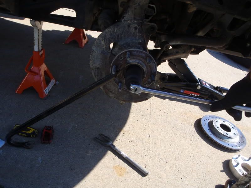

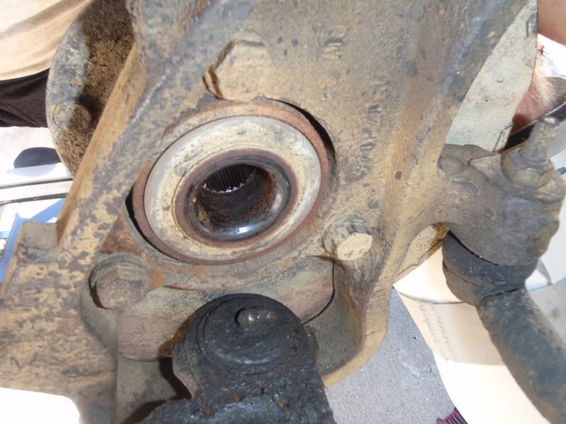

11) remove drive axle nut (35mm stock / 36mm aftermarket) use a prybar to hold the hub stationary

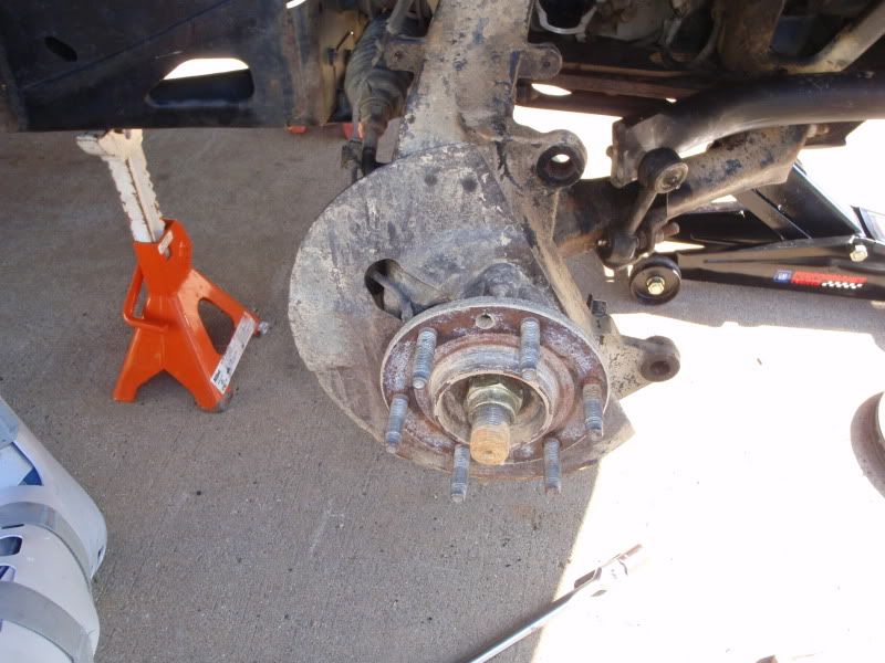

12) remove the three hub assembly bolts (normally you will have to work around the CV Shaft, however mine was broken and has previously been removed)

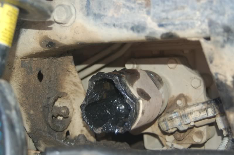

13) remove the axle from the front axle 4WD disconnect, the easiest method for me was to get a pickle fork on the bottom side of the inner CV housing and give it a couple of good hits with a small sledge. There is a spring clip on the end of the CV shaft that has to compress for it to come loose. This step is going to be entirely trial and error for you until the shaft pops free.

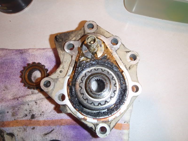

this is a good opportunity to clean out the old the old grease in the front axle 4WD disconnect. Remove the front axle 4WD disconnect from the engine block (4 - 15mm bolts)
once removed from the vehicle remove the remainder of the bolts and you should be able to pry it open.

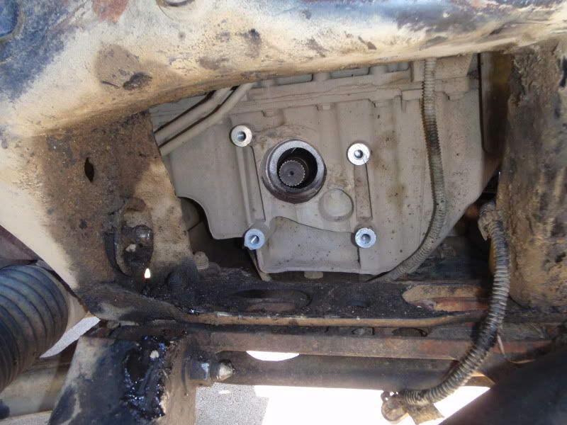

by Regulator1175 » Sat Oct 02, 2010 1:49 am
I replaced both front CV shafts a few weeks back, and in the process cleaned out and repacked the passenger side disconnect with new grease and changed my front diff fluid. I have since had a decent leak, and have been throwing diff fluid all over the drivers side of the wheel well and engine compartment. I obviously have a seal leak at the CV shaft.
Today I tore it all back down again, and replaced the seal. What a huge pain in the a** that was. First off the CV shaft did not want to come out of the front diff. I pulled and pried and couldnt get it to pop free. So, a trip to Advance and spent $130 for their "loaner" slide hammer that is meant to pull the CV shafts. In reading the directions at the store it shows that you thread it onto the wheel side of the shaft and pull it out that way. This didn't make sense to me, so of course I asked. The answer I got was "Best I can tell you is go home and give it a shot. If you break the CV shaft while trying to get it out with our tool just bring it in and we will replace it for free." He even checked and they had two in stock. So I figured what the hell, lets give it a shot.
When I got back home, I decided best course of action was first to see what the travel was going to be like in the CV shaft. It appears the outward limit to travel is the boot itself. So of course the slide hammer will do me no good at this point. I decided to default to my favorite tools, the BFH and pickle fork. It took some tight maneuvering, but I am happy to say it did finally come out.
Next came the seal replacement. After sitting there and scratching my head for a few minutes wondering how this was coming out it dawned on me, the slide hammer was sitting in the back of my wife's Bravada. The kit had a 90* claw piece that screw onto the end of the slide. It worked out just right to get behind the old gasket assembly and with a few good hits working it around the ring I was successful at popping out the old gasket.
I was now out of light, so re-assembly will likely take place Sunday morning. Lets hope this solves my leak.
