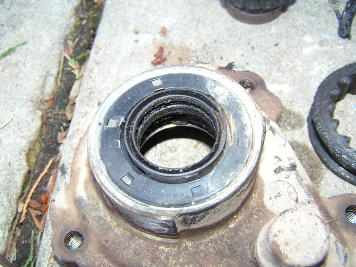

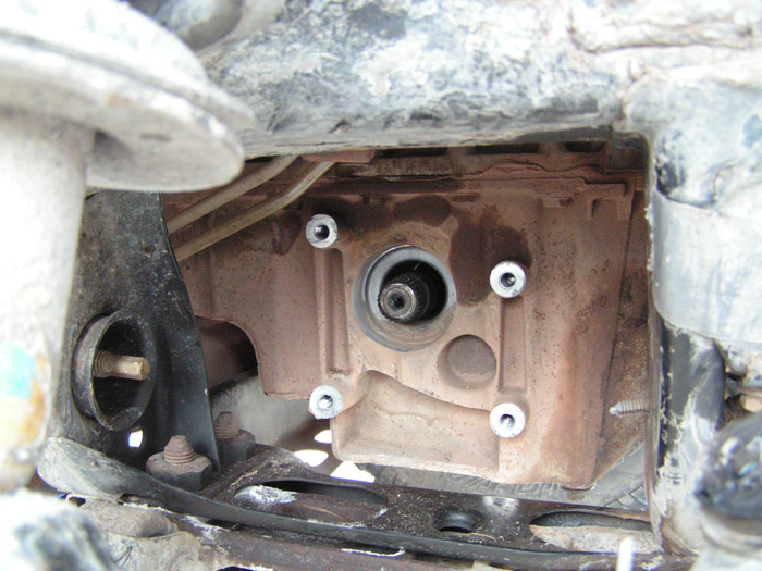

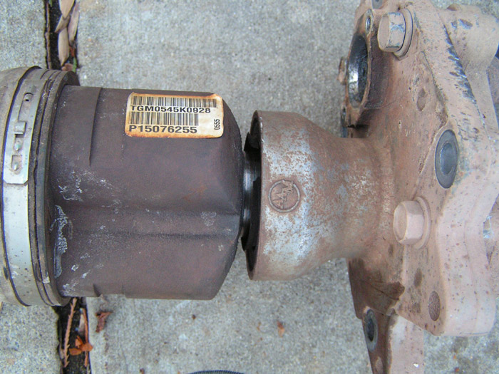

So I finally had a free weekend to get some work done on the truck... so the actuator demanded some attention. I got the assy out and was able to crack it open... it was worse than I had originally figured.
So, as of now, the truck is not drivable, as the intermediate shaft needs support, otherwise it will destroy the inside of the oil pan.

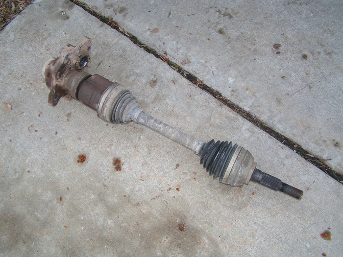

You have to remove one of your end links to remove the CV shaft... mine weren't cooperating one bit... so bye bye!
The shaft and disconnect assy once removed:

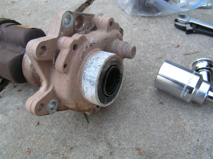

You can see here, the seal is ruined and there's wear on the CV shaft:

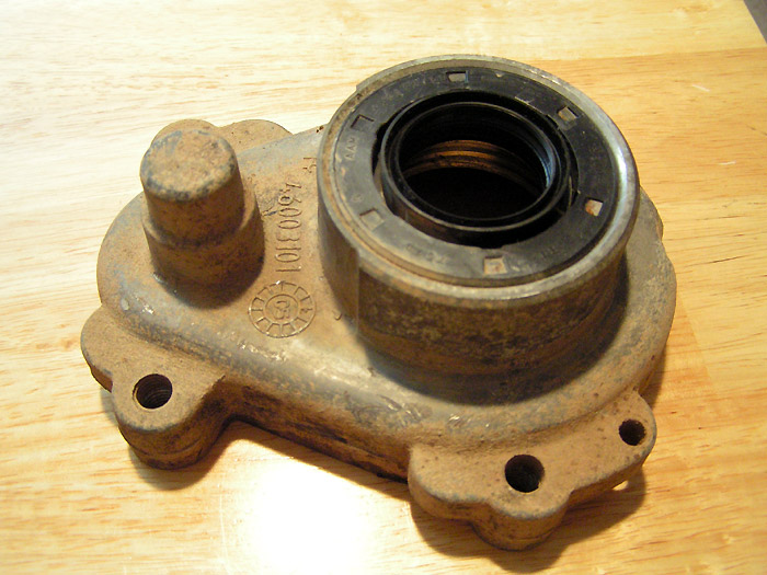

I had to really wrestle with this... there's a tight fit between the assy and the oil pan. After going through a few water holes, I guess dirt and silt gets in... and just becomes glue. I had to pry on it for a good 20 minutes before getting it out.

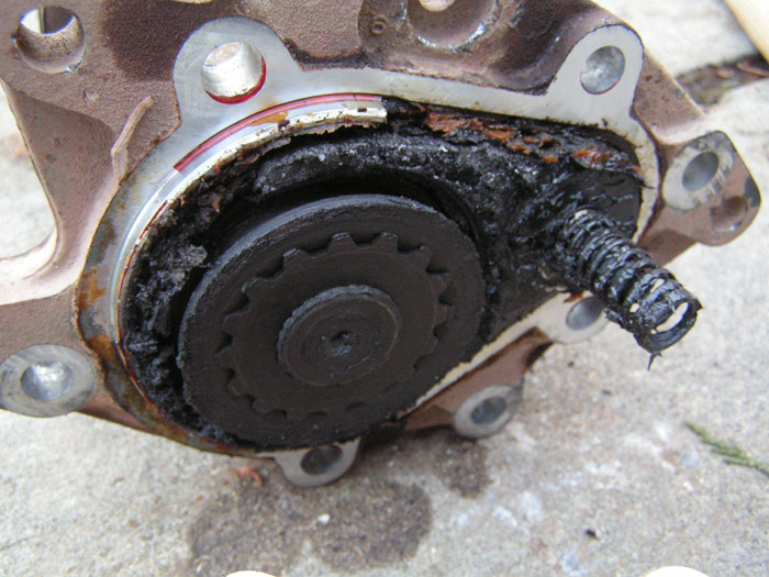

Cracked open... my first look... worse than I thought:

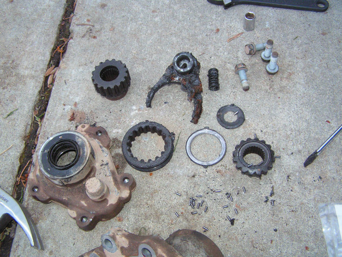

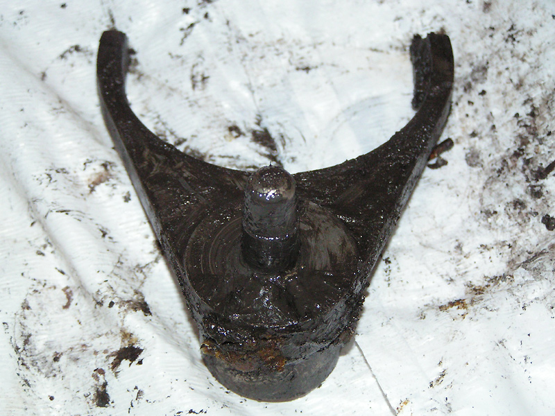

View of the fork and shift collar. Fork is not broken, but extremely worn:
The pieces... as you can see, there were some issues with the bearings... out of the 3 (I think) bearings, none survived, and the outer two were utterly destroyed. The needle bearing rollers were basically dust:
Interior seal... still intact, but even then, the bearing was destroyed.
I'm going to take it to work to clean the grease off the parts and try to figure out what exactly needs to be replaced. I had ordered some preliminary parts, but it needs much more work than I had imagined.

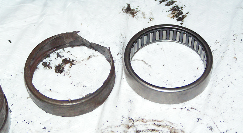

Well that's just it... nothing really broke. That outer seal must have rotted out, which just lead to extreme wear. And the worst part, is there's no real warning or bad noises. Just the occasional rattle (and 4WD being temperamental).
This is how worn the outer bearing was... left, the old bearing, right, a new bearing.

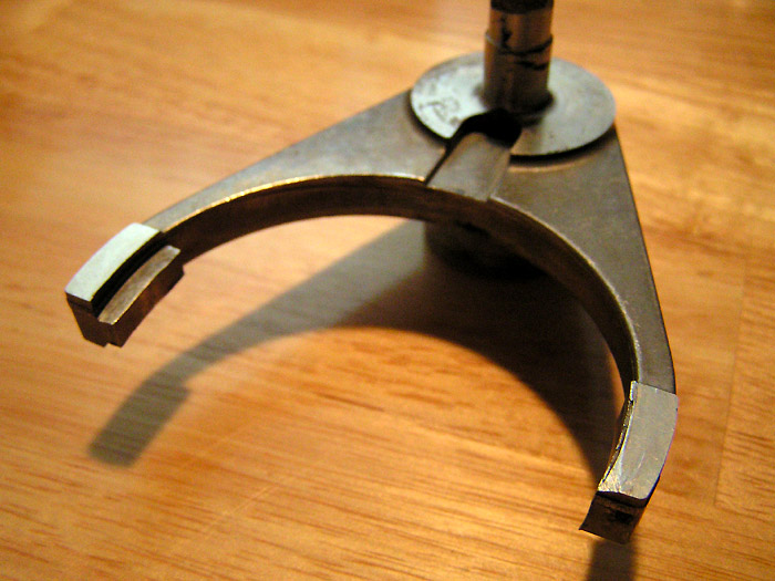

The fork was not broken, however, if you notice at the ends of the fork prongs, they have what looks like wear pads. Only these pads engage the shift collar. As you can see here, there is no left pad, which apparently was worn away because of the CV shaft sitting angled, due to the death of the outer bearings.

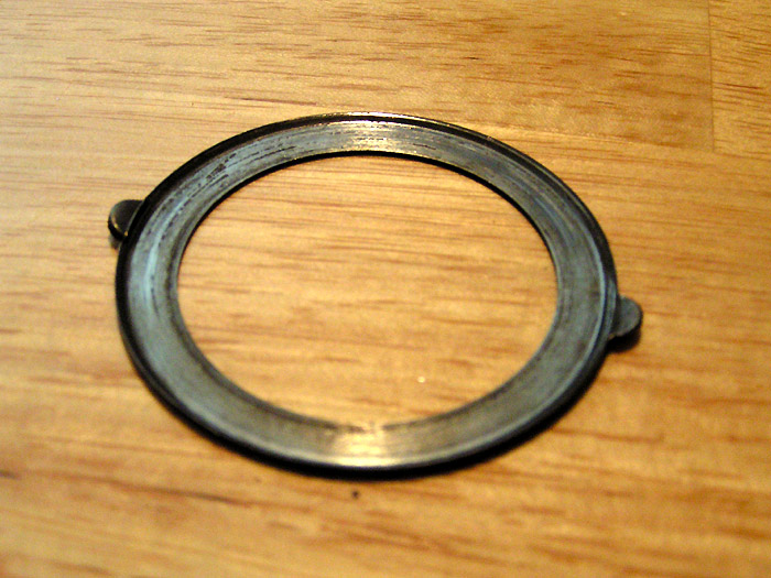

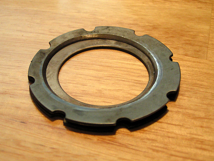

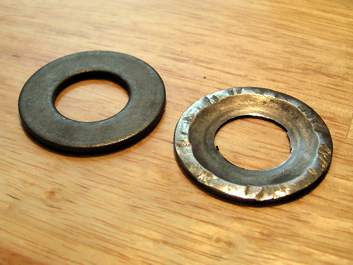

This is another example of the wear. This is a thrust washer that sits between the input and output gears. Due to the offset of the outer gear, it wore away the interior of the washer into a bevel.

Dorman is still working on the fork. We'll have rebuild kits available and a outer housing soon. James check your outer housing the few bad ones I have here are junk. When the outer bearing goes it starts to ride in the aluminum housing and wears it down bad. So bad that the new bearing won't press in it just drops right in. Let me know if you have trouble getting parts from the OE if I can help you I will.

As for the thrust washers... I realized that us lifted guys have a slightly more complex issue. I assume that the samples you have are from non-lifted guys. With a non-lifted truck, there's no moment being forced on the CV shaft due to the tripod joint boot being bent (as a lifted truck's is all the time).
That moment creates a couple across the front two bearings... down on the outer-most bearing, up on the outer-gear bearing. This cocks the whole outer gear up at an angle. That induced couple is why my outer-most bearing was completely eaten away on one side only... just as my shift fork is eaten completely away on one side... and the other shows normal wear.

The fork will be a totally different as for the material I'm not saying as of yet. Also I've seen 3 people need that outer half of the housing and that it over $200.00 by itself. James I don't know if the truck we're lifted that i got my parts from, but I'm pretty sure 1 or 2 of them were. And yes there is 3 bearing and they're all the same and all should be changed. Oh and another thing there have been guys that have needed the shaft that goes thru the oil pan and that's another $260.00

Fork, notice the wear pad is gone on the right prong:

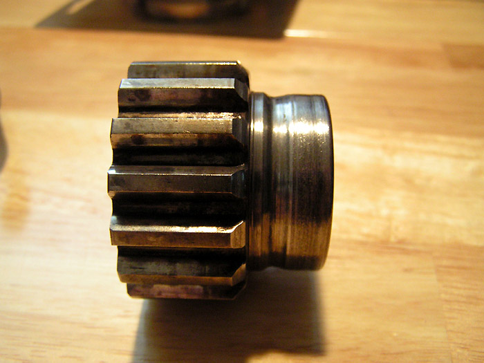

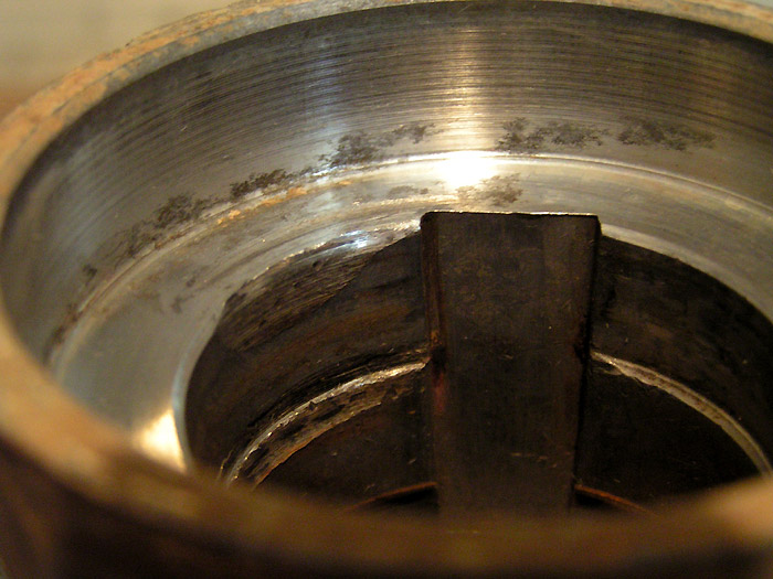

Outer gear, notice the groove worn into the gear:

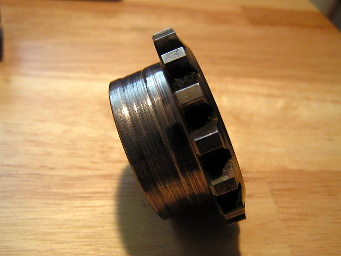

Inner gear, not as bad as the outer, but still shows galling:

Showing the old thrust washer vs. the new thrust washer. Old on top:
Inner thrust washer, worn due to the offsetting of the outer gears pushing on the inner gear:

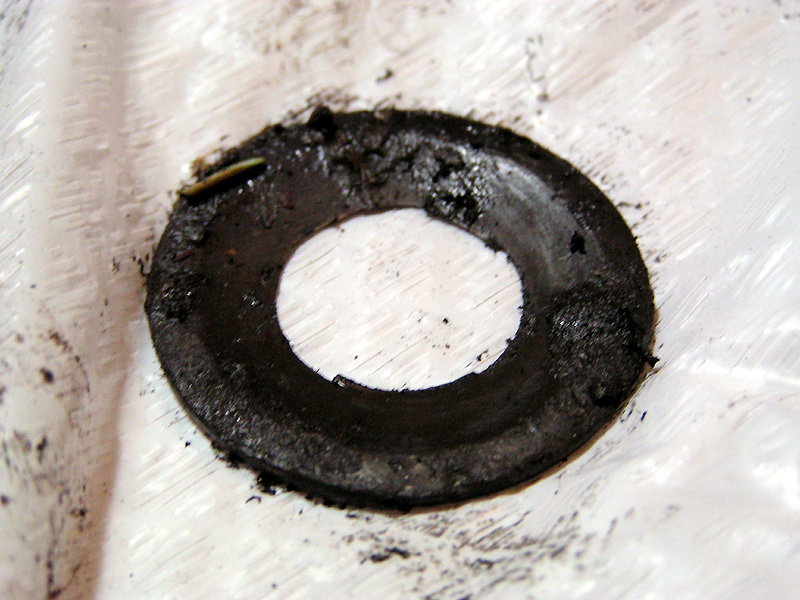

Middle thrust washer, cupped due to the CV shaft poking it:

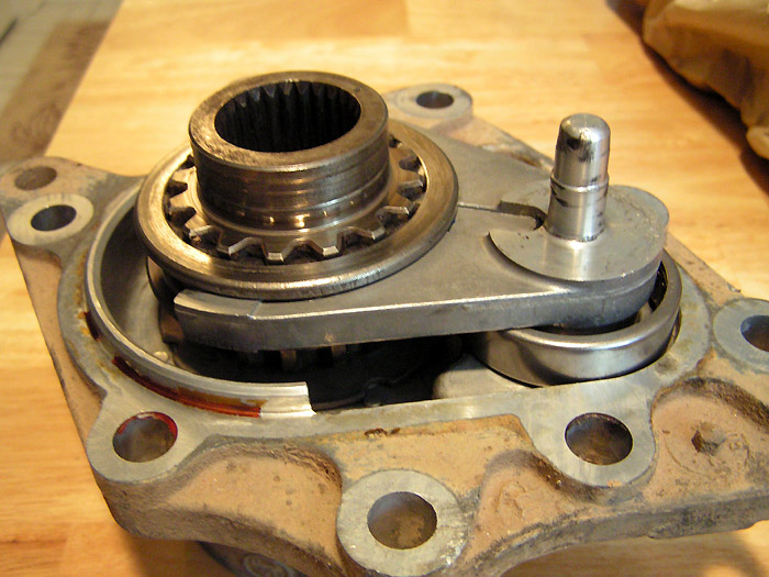

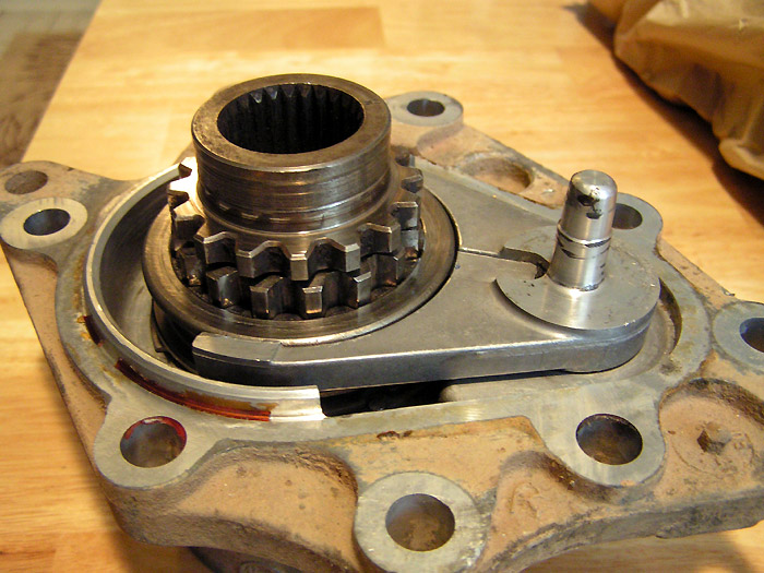

Assembled, showing how it works, for your reference:
Showing the assembly in 2WD mode:
The top gear would be connected to the intermediate shaft, the lower one connected to the CV shaft. When in 2WD mode, the two gears counter-rotate due to the freewheel of the differential.
4WD mode:
The spacer under the fork is there to simulate the actuator pushing on the fork... not part of the assembly.
