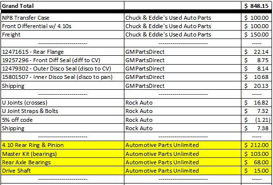

Here's what I'm thinking as of right now...
Going to replace seal to CV on the "new to me" front diff. Finish rebuilding the spare disco that I have. Replace all the bearings in the rear axle/diff while doing the 4.10 swap.
New fluid in both diffs and TC.
Am I missing anything?
I'm still looking at other options for rear pinion and gear... I've seen them a little cheaper on other sites...

I think you can get that 4.10 ring and pinion cheaper. Have you checked rock auto? I saw some smoking prices on USA standard 4.10s. Like half what you've got listed.
by dvanbramer88 » Fri Aug 30, 2013 8:00 pm
JamesDowning wrote:I think you can get that 4.10 ring and pinion cheaper. Have you checked rock auto? I saw some smoking prices on USA standard 4.10s. Like half what you've got listed.
Actually, I saw them too. Rock Auto does have ring and pinion sets for the TB 8.6" axle. I was looking around at stuff a few nights ago to satisfy my own curiosity. And they were pretty cheap. Like ~80-$100 IIRC. They also have a bunch of ratios other than the standard 3, making the front diff the limiting factor on the availability various of gear ratios.
by Moots1288 » Fri Aug 30, 2013 9:05 pm
Look into Yukon gears.
by Gordinho80 » Fri Aug 30, 2013 9:25 pm
$129 shipped for the US standards... ZGGM85411
Yukons are much more. Trying to keep costs down as much as possir. Still have to find someone to install it.
