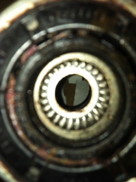

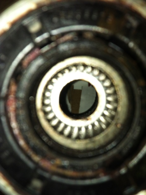

by Mooseknuckle » Thu Apr 12, 2012 10:23 pm
Here ya go. Best picture I could get I'm a little drunk. New disconnect is in and 4 wheel drive hi and low is working very well. I'm still out 500.00 that was my trip money. So I'm still on standby. Dammit I could wring that dudes neck. Been looking forward to this trip for months

by Trail X » Fri Apr 13, 2012 9:13 am
I honestly can't tell much from that image...

by Mooseknuckle » Fri Apr 13, 2012 3:11 pm
Lol no but for food and anything extra. It's hard to tell in that picture you can see it when ur looking at it.
