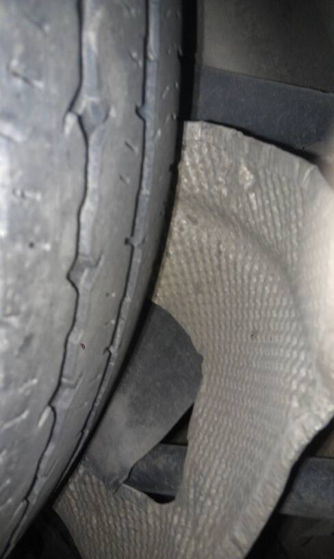

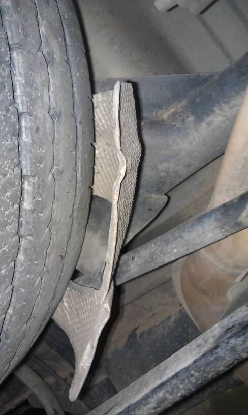

Driving around yesterday I started to hear a bad rattle/grind coming from the rear. I looked closer and could hear it from both sides.
After I got under it, everything looked fine except for this loose thing above my spare tire. Hopefully you can tell me what it is, and/or how to fix issue. Thanks.

Your pic is just showing the heat shield for the spare. Drop the tire and tighten it up if its loose.

by AceOfSprings » Fri Aug 31, 2012 4:11 pm
Thats what i needed, thanks. I am not mechanically inclined in the least, so the simplest of things escape me 8-)
