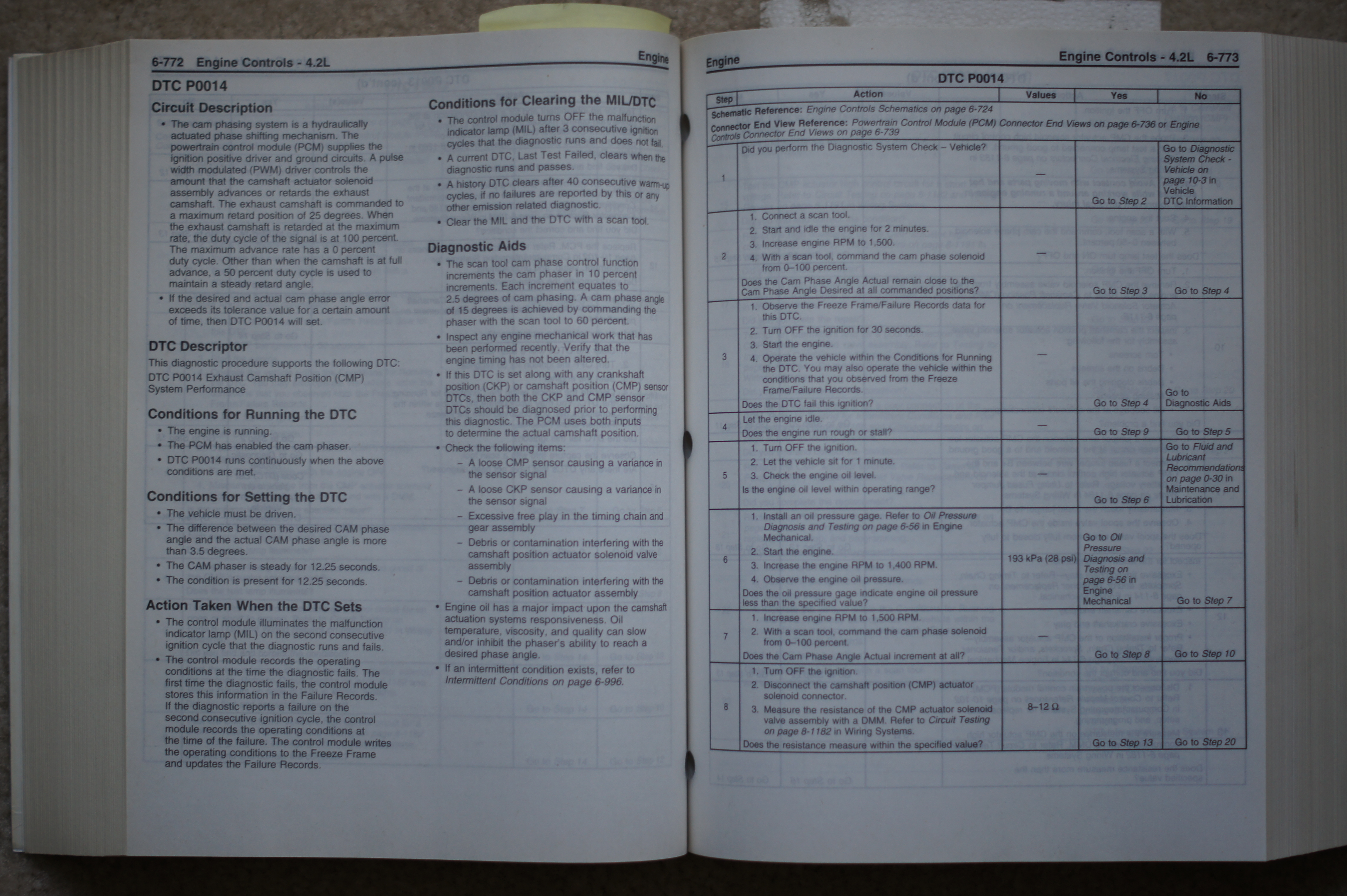

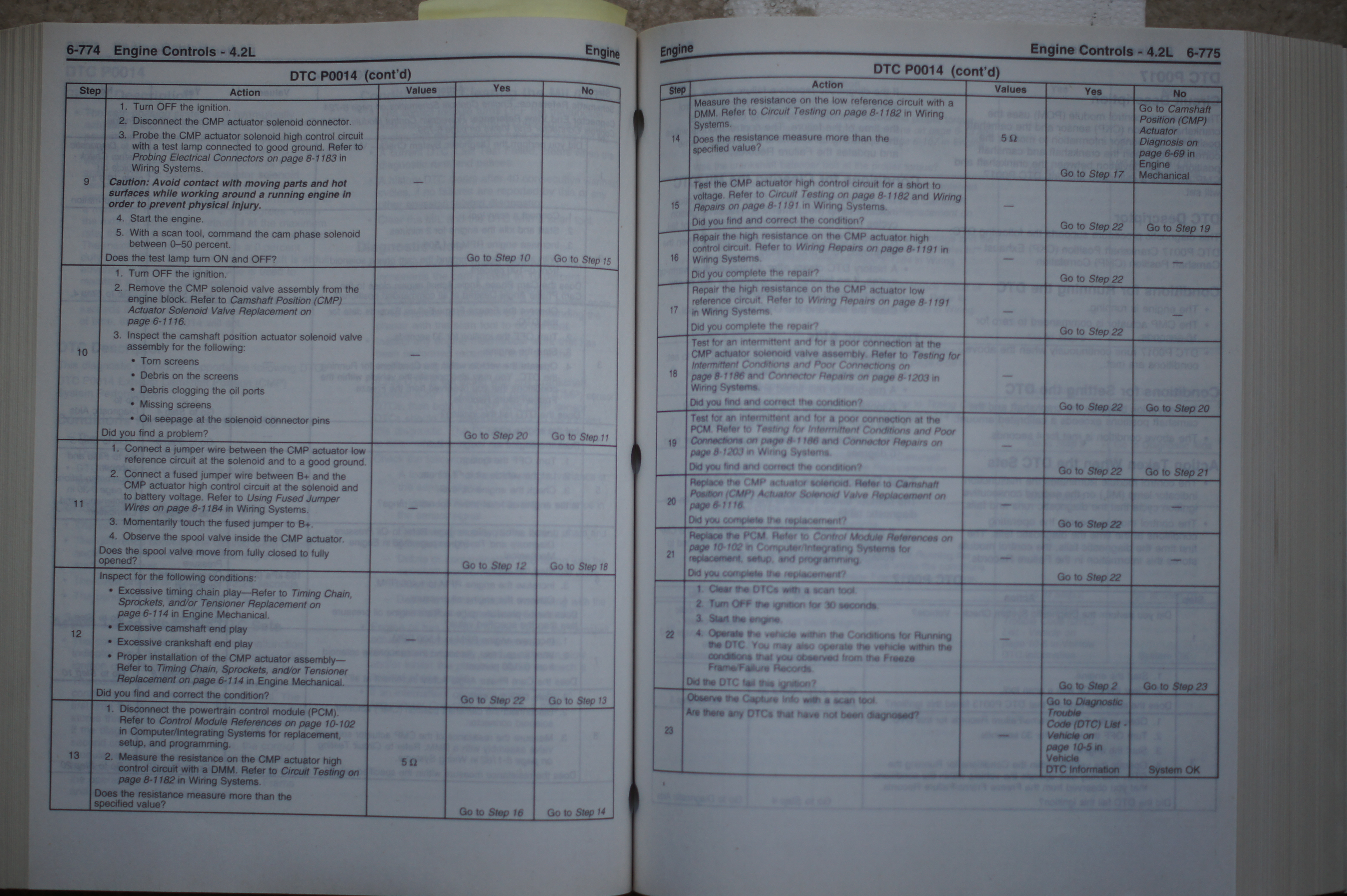

Ok so this code came up, I have replaced cam and crank sensor, also the cam position actuator(thinking I got a bad one) P0016 is the only code coming up. I don't know what else to replace or try, and suggestions? Symptoms, rough idle, exhaust smells rich, cruise control not working, lacking power, the timing is clearly off, I just can't see what I missed.
